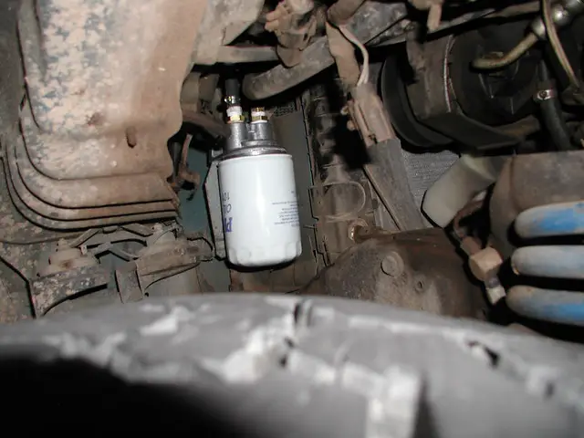

you can also do what I did and that is after the heat exchanger in the radiator I then put in a spin on oil filter then ran the line to my coolers and then to the return to the tranny . This gives me about 1 Qt more of oil and a ton easier oil filter change for my tranny. It also will now have you filtering you oil twice .once with the stock filter and again with the new spin on.
