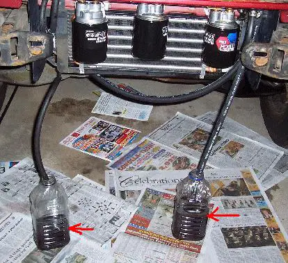

This morning I set up a test to determine for sure which port on the 5R55E is the output. I disconnected both ATF tubes at a convenient location and connected each to a drain hose going to a container as shown in the photo below. The engine was cold when started and ATF immediately flowed from both hoses.
However, after only a few seconds you can see that the container on the right contains almost twice as much ATF as the container on the left. The tube on the right is connected to the upper port of the 5R55E case. When I did my first flow test, I only disconected the hose on the left assuming that there would be flow only from one tube. Apparently the anti-drain back valve in the oil filter prevented flow from the actual outlet port. The check valve also explains why the filter housing never got warm to the touch even after 30 minutes of running the engine and why the ATF oil temperature gauge never read above its minimum. There was no flow!

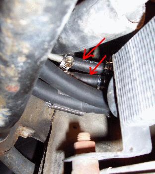

I'm not going to replumb the filter mount and coolers because the way they are now reduces the length of hose and restrictions to flow. Instead, I plan to cut the ATF tubes where they are parallel as indicated in the photo below.
I'll flare the tubes ends if able. Then I'll use hose and clamps to connect the transmission side of tube A to the cooler side of tube B and the transmission side of tube B to the cooler side of tube A - thus achieving the desired flow direction to the input of the oil filter mount.

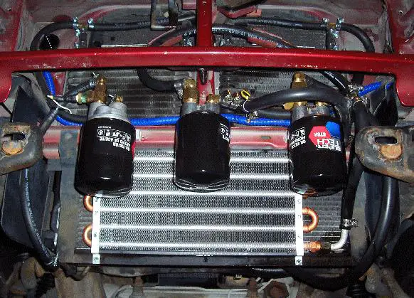

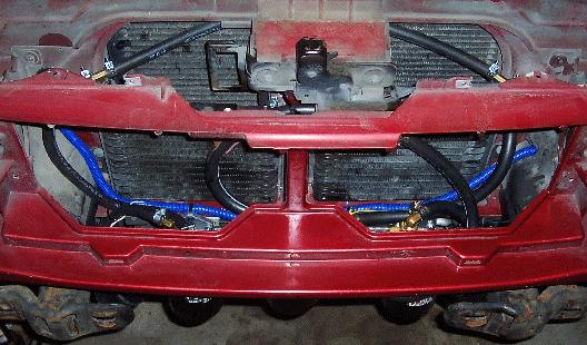

Plumbing Complete!
In the photo below the hoses that were inserted to change the flow of ATF to the remote oil filter mount are identified.
The photo below is looking down at the completed plumbing after repositioning some of the hoses to reduce interference with the grille.
The blue flexible conduit contains the wiring from the MAF sensor amplifier and the oil temperature sensors that is routed to the yet to be installed pillar pod.
The photo below is looking up at the completed oil coolers/filters with plumbing.
Heat shrink was applied to the oil temperature sending unit terminal connections to prevent corrosion from moisture.

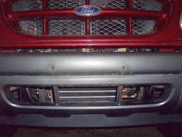

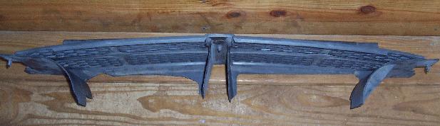

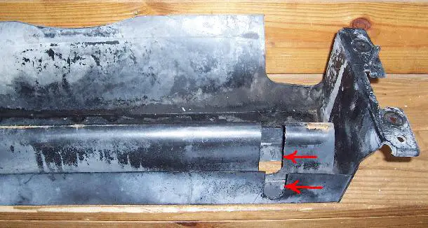

The photo below shows the grille after trimming the back to eliminate interference with the repositioned and new ATF oil coolers and engine oil hose.
The modified oil management system passed a 5,000 rpm leak test with a quick rev to 6,000 rpm. Future oil related enhancements include installation of an engine oil pressure sending unit and an Accusump oil accumulator. But for now it's time to reassemble the front.

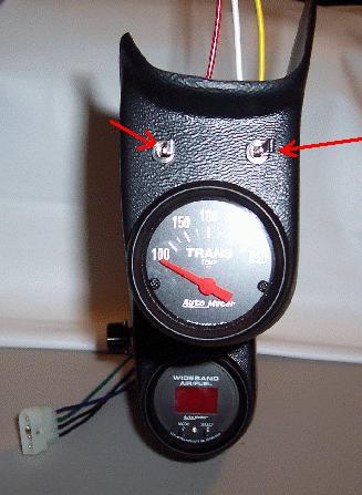

Pillar pod assembly

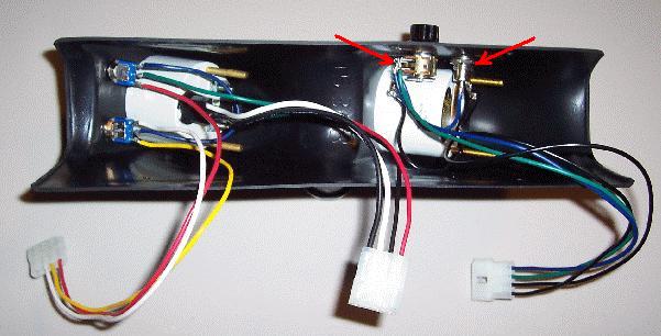

The photo below shows the completed internal wiring and assembly of my multifuntion pillar pod assembly.
The left half is associated with oil and the right half is associated with richness. The connectors will allow for the installation/removal of the entire assembly.
In the photo below the switch identified on the left selects between displaying oil pressure and oil temperature. The switch identified on the right selects between displaying engine oil temperature and ATF temperature.
Next comes cutting holes in the pillar trim for the mating connectors and then running the lighting and ignition switched power wiring from the instrument cluster wire bundles that connect near the passenger kick-panel.

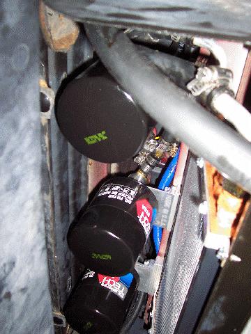

The photo below is a bottom view of the coolers/remote filters prior to attaching the air deflector that mounts below the radiator.
There is enough room to replace the filters (even the larger bypass filter not yet installed) without removing the bumper. However, the air deflector will have to be removed for filter replacement. I may need to modify the air deflector for the engine oil return hose. The front of the vehicle is shown below.

The photo below shows the completed installation of the pilar pod mounted multifunction oil temperature/pressure gauge.

Did that pillar pod fit that well to the pillar, or did you trim it some to make it fit that well? I have one also for trans temps and boost, and it will need to be painted to match the gray. I asked because I could easily live with it bolted on like you have it with the seam there. I thought they would have more gaps in them.
Pillar pod
Did that pillar pod fit that well to the pillar, or did you trim it some to make it fit that well? . . .
Its exactly as AutoMeter made it except for the holes I drilled in it. I made sure it was pressed tightly against the pillar trim when I drilled the mounting holes. In a few days I should have some driving temperature data to report.

Below is a photo identifying the slots I had to cut in the air deflector for the engine oil return hose.

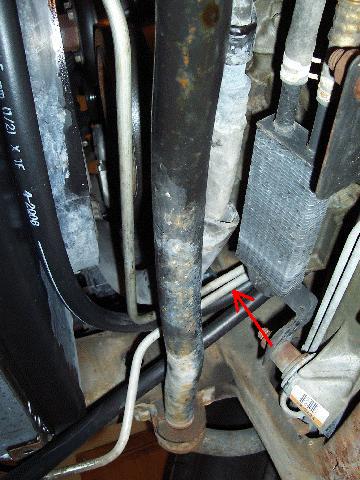

Hi there, on your last picture are two pipes, one next to battery and one with green cap and there is written hand tightening only. In black one is air, is it right so? I cant find it in my explorer manual.
