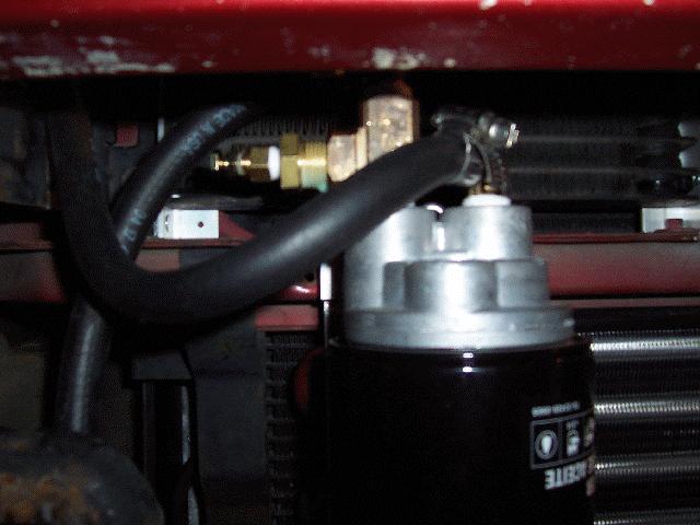

Last night I won the bid on the Auto Meter transmission oil temperature gauge. I'll reconfigure my plumbing at the inlet to the transmission oil remote filter for the sending unit. Later I might buy another sending unit and add it to the inlet to the engine full flow filter. I really like Al Franklin's way of mounting the gauge in a pillar pod and then installing a switch to select between engine and transmission oil temps. I prefer analog indicators over digital because rate of change is more obvious.
