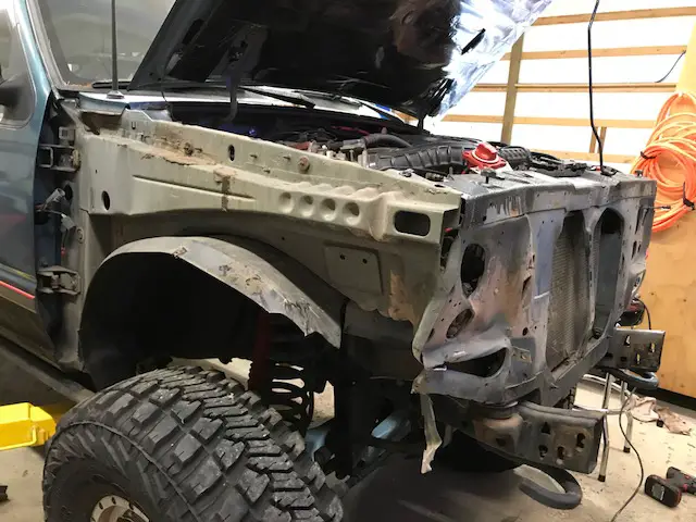

Nope, too busy with other projects. . . Kevin and I started take-down a few weekends ago (it's at his shop up the road a bit), so still in pieces.

Sorry for the slow response - - and thanks for the comments. Rig is still in pieces up at Kevin's shop, not sure what the future holds for it. Damage not extremely debilitating, but the frame is tweaked and it's now a "salvage" title, and struggling with how much money to throw at it . . .

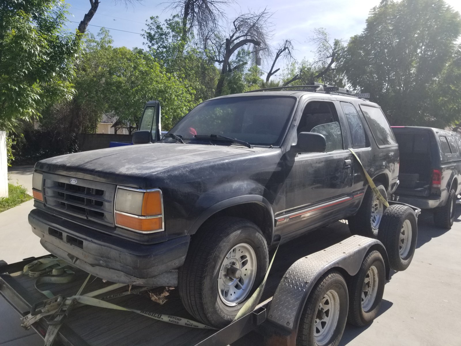

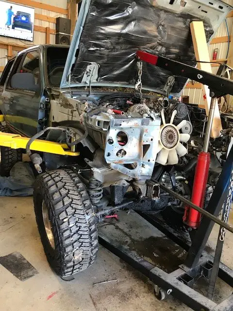

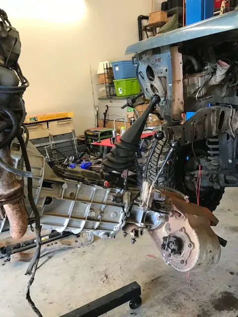

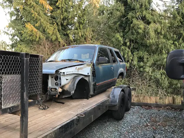

End of the road . . .
Long time coming, but saying goodbye. Some stuff sold, some stuff stored for a potential resurrection in the future. . .
In the end, the frame was tweaked and the core support would have taken "professional" effort to repair - - too much for a salvage vehicle. . .
No, the Atlas II is not for sale. . .
Junk Yard ready. . .
Paul

Again, thanks for the offer, but going a (slightly) different route. . . As the Sport had front end damage, once we got in deep we found the motor mounts were FUBAR, front axle "tweaked" and like mentioned earlier, too much professional effort for a "salvage" title.
But at the end of the day, too much "good stuff" to just sell off - Atlas, lockers, gearing, SuperRunner steering, 3/4 doors(!), storage drawers, Corbeau heated seats, winch, rear tire carrier/bumper, and blah, blah, blah the rest of 27 years of ownership. . . Plus having Kevin (DiffWhack) just up the road to help with all the heavy lifting.

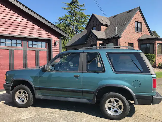

1994 'Sport clone, correct transmission and only 83,000 miles (odo is 7 digits, so hasn't rolled over). . .
Even kind of like the "black & tan" interior - - won't have to worry about Moab dust on this interior. . .

Nope on that price, but it was a single owner vehicle in salt-free Washington, has the sunroof, power lumbar front seats, cold AC, Carfax with most all the service records and some other stuff: $2,950.00, plus tax and title. . . Some might think that's too much (like Kevin), but most I've looked at here in person or on-line are 200,000+ miles and roached everything. . . How often does a sub 100K, 2 door with manual pop up?
A couple of minor issues need to be addressed before swapping over the major components, but I'd trust this rig to drive to Moab tomorrow, well, maybe if the relatively new tires were a bit taller than 26" . . . (225 75R 15[!])

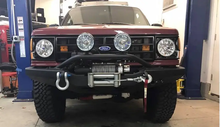

Suspension plan a bit different this time - - still keeping the Dana 35 TTB, but sold portions of my front axle to a third party and will sling Phil's (Albino94ltd)'s TTB up front. Like mine, it has the ARB, but Phil mounted F250 shock mounts that gave him far superior "droop" to my fairly limited articulation. I had some radius arms made after breaking my old Rancho set on "Upchuck Hill" in 2013 and those went with my front axle, so I'll run Phil's Duff set on this rig. Right now have Duff 5.5" coils from Phil, we'll see if those work or whether they'll need a trim.

And the Atlas II - - one of the reasons for pulling the trigger on this rig was the fact that with the manual transmission we wouldn't have to fabricate or purchase "adapters" for the transfer case, have a brand new spare set of driveshafts that'll bolt right up. . .

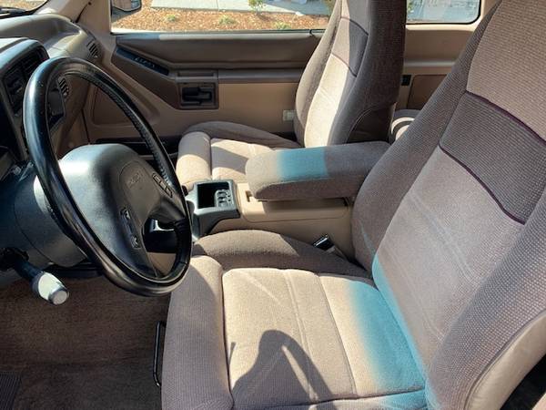

Few more pics of the new rig:
Paul
