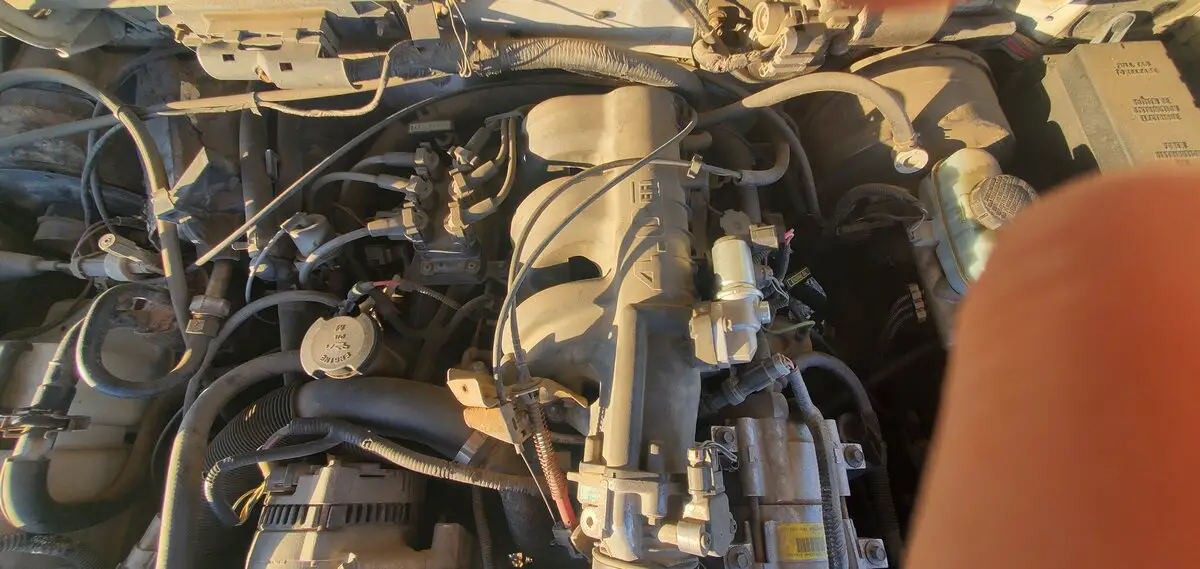

Take pictures of the top of the engine, I'd like to see the heads. The fact there is oil coming down the sides of the engine, the front main seal is one of the leaks.

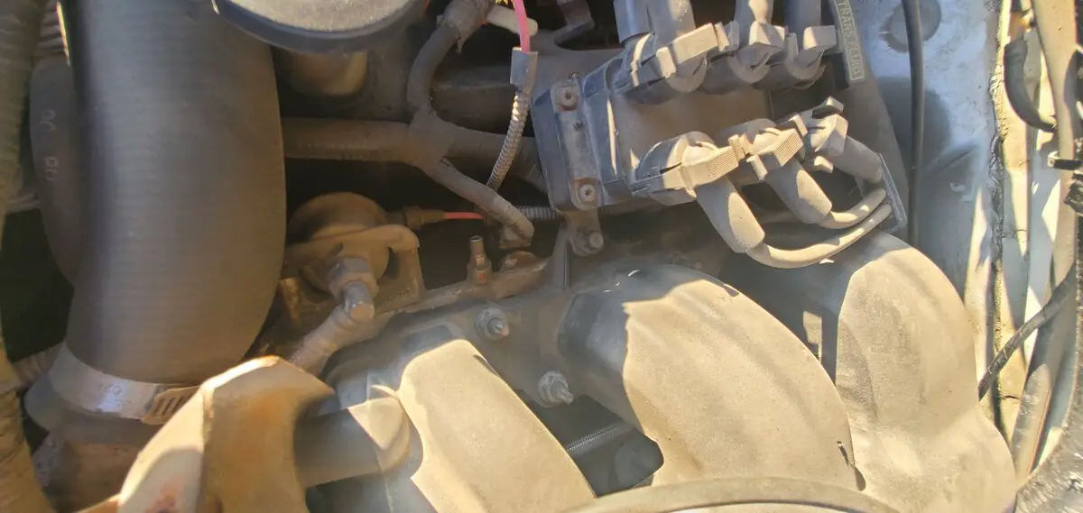

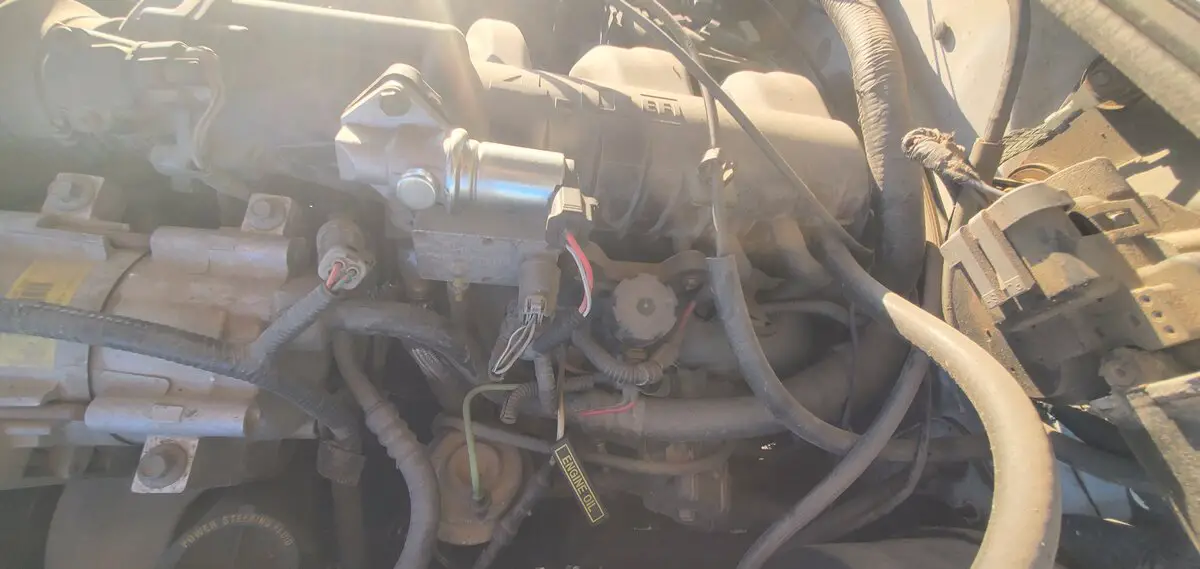

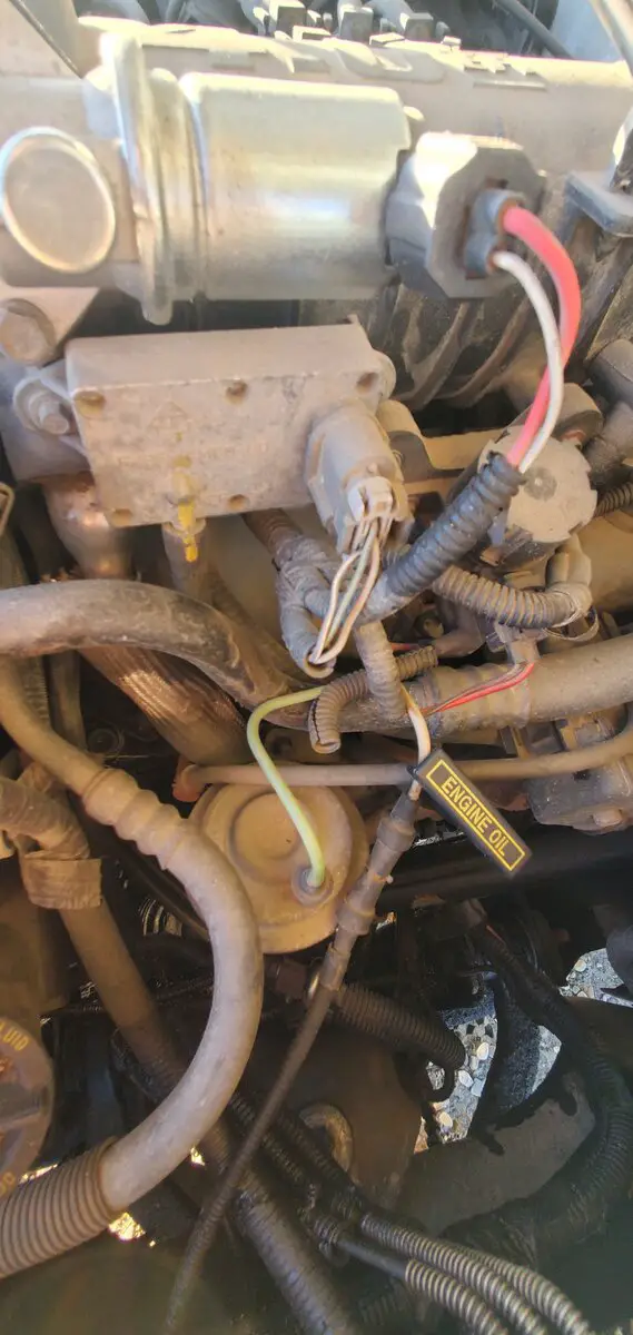

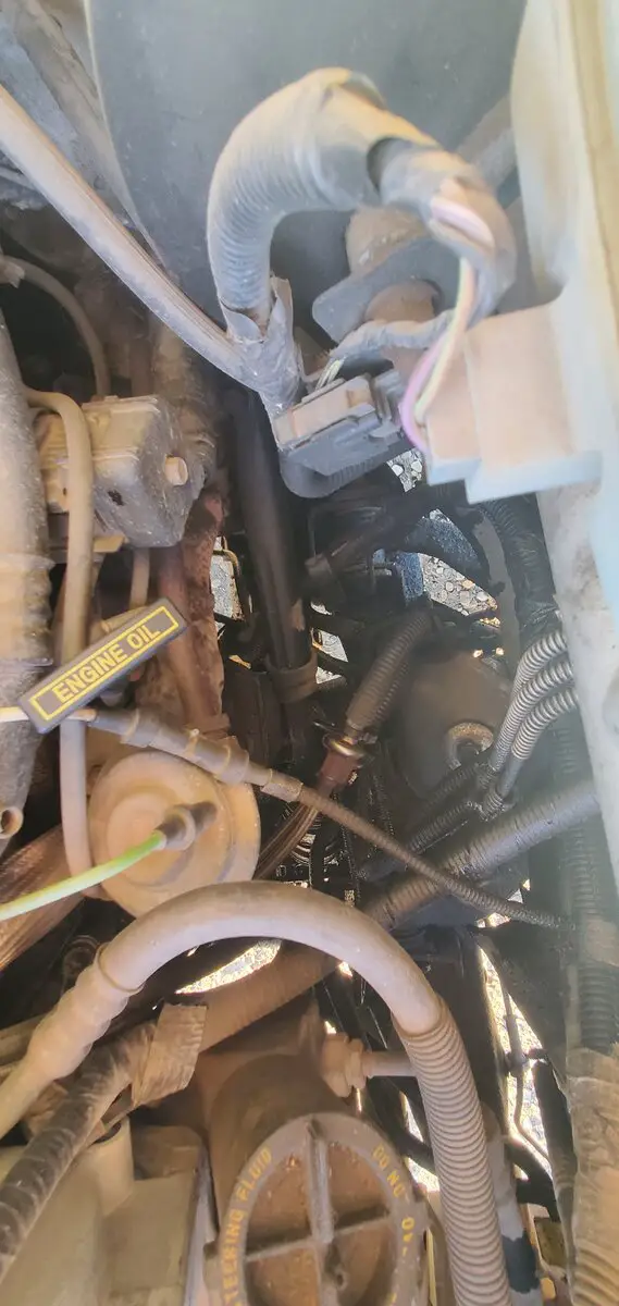

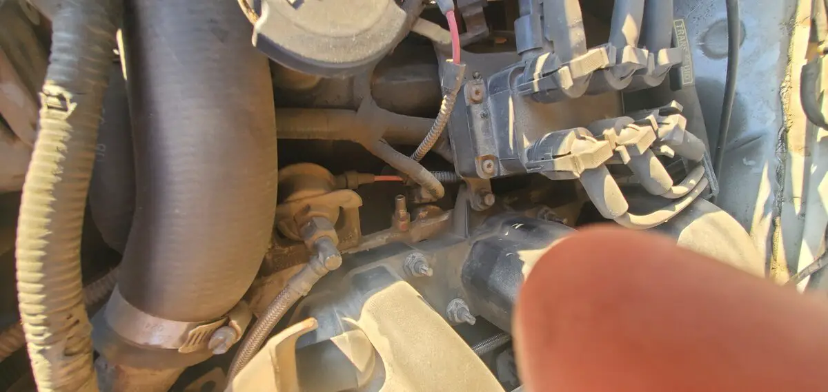

Hope these work? If not I can take new ones. Its still dry up at the engine.

Every possible place that motor could leak oil, it is. The oil/dirt buildup around the exhaust manifolds will eventually catch fire.

Wonder if the oil pressure sender is leaking? But then, it would need replaced and I doubt that's gonna happen here
