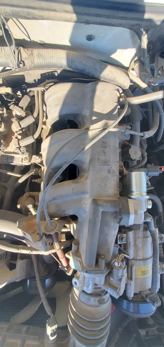

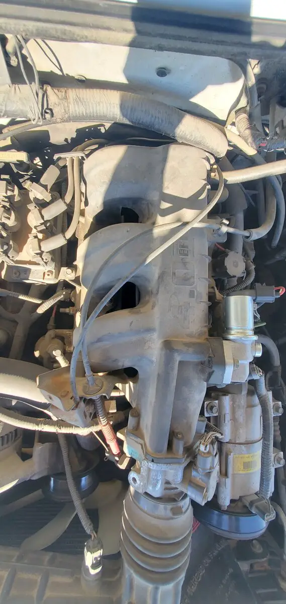

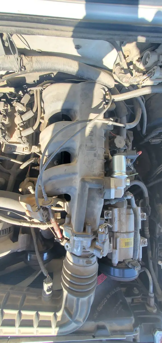

Take pictures of the top of the engine, I'd like to see the heads. The fact there is oil coming down the sides of the engine, the front main seal is one of the leaks.
Got some more. No leaks from the top of the engine from what I see. Bone dry.

Your intake manifold is bone dry, I'm surprised. The sides of the engine is where the oil is coming out, probably needs new gaskets on the valve covers.
New intake manifold gaskets were put on in March of 2021.The entire motor was also torn apart (right down to the heads) at the same time and thoroughly cleaned (hence why they're still clean). Both valve cover gaskets were replaced at the same time. I took a peak about 4 months ago and the valve cover areas were completely dry.
I have a feeling it could be the heads leaking. And this may be hard to believe but the oil pan leak is the worst leak of all of them because I believe that it is leaking out of the oil pan gasket too too. The entire gasket and oil pan would for sure have to be replaced.
