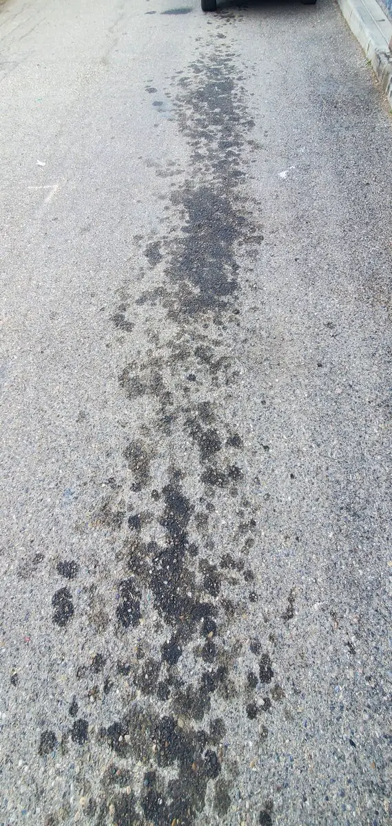

Here's one spot at the back. Its not all mine, they were already here for years but I've made it a tiny bit darker over the past 5 months. Personally I think it looks alright. I'm sure I'm not the only drivet with a leak.
Go purchase a cheap bag of oil dry or kitty litter and pour it all along the drip trails and everyone driving through it will scrub it in. All done. All good!

That “drip trail” is awfully wet to have only gotten a little darker recently. I wouldn’t want that it my lot, it looks terrible.

That's from many years of a lot of delivery drivers passing through the back and obviously a bunch of cars had leaks. It's always been dark, I just added to the spots but I don't think it's as bad as the boss is saying it is. I mean the oil stains go all the way to the end of the curb and he's got oil stains all over the sidewalk and right outside his back door. Does the kitty litter really work? I shouldn't have to pay for it out of my own pocket. If the owner paid for it then I would be fine with it.

i wonder if you clean it once out of "good faith" maybe boss moss wont be so harsh on that? must say it kinda looks bad though, with all that oil :p not saying its on you, just as a whole. maybe he could be upset by that and that compounded with your current leak? dunno.

That oil isn’t all old. It’s still wet. You’ve been given all the advice you could, and you’re going to use none of it.
Your boss also shouldn’t have to pay because you refuse to upkeep your vehicle. You’re lucky you don’t get fined $$$$ for the gallons of oil you’ve been irresponsibly dumping on the ground in the attempt to save yourself some money.

That oil is from the same vehicle, too much of a pattern not to be. Better get some kitty litter and a brick. Brick the kitty litter In, like scrub it in with the brick . Boss will be impressed.
