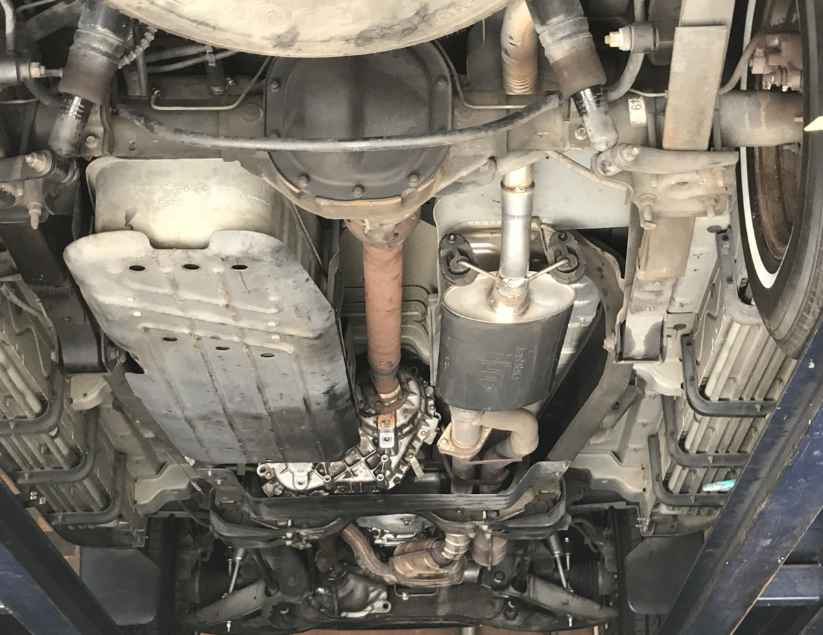

I couldn't see if the cats were wet today. I can't find the one that's right near the oil filter. I've been driving the truck like this for the past 46 months. I think the leak before was worse as both valve covers were leaking and the timing cover gasket too.
If oil burns on the cats, will it always smoke? I'm guessing you will smell and hear it?

usually you smell it, dont really hear it like cooking oil.
also, was wrong. both are on the PS i thought the bank 1 one ws on the driever side and both merged, but guess not.
Screen Shot 2022-10-13 at 7.38.17 PM.png Screen Shot 2022-10-13 at 7.38.26 PM.png

View attachment 435545 View attachment 435546
I wonder what the smell is like. I'm guessing it's a strong burnt smell like burnt ATF.
How come your oil pan looks so different from mine? My driver side is the wet side of oil and the passenger side is completely dry. Guess it works out with the pics you posted.

close enough.
the sohc has a 2 part oil pan, and the pan you see there is the trans pan ;)

Your 96 Y pipe is way different then the 98+ Y pipe in 98 they started putting mini cats in the Y pipe
interesting! when in 98 was it addrd? this is a mid year (summer) build and it only has 2 cats, no mini cat etc
