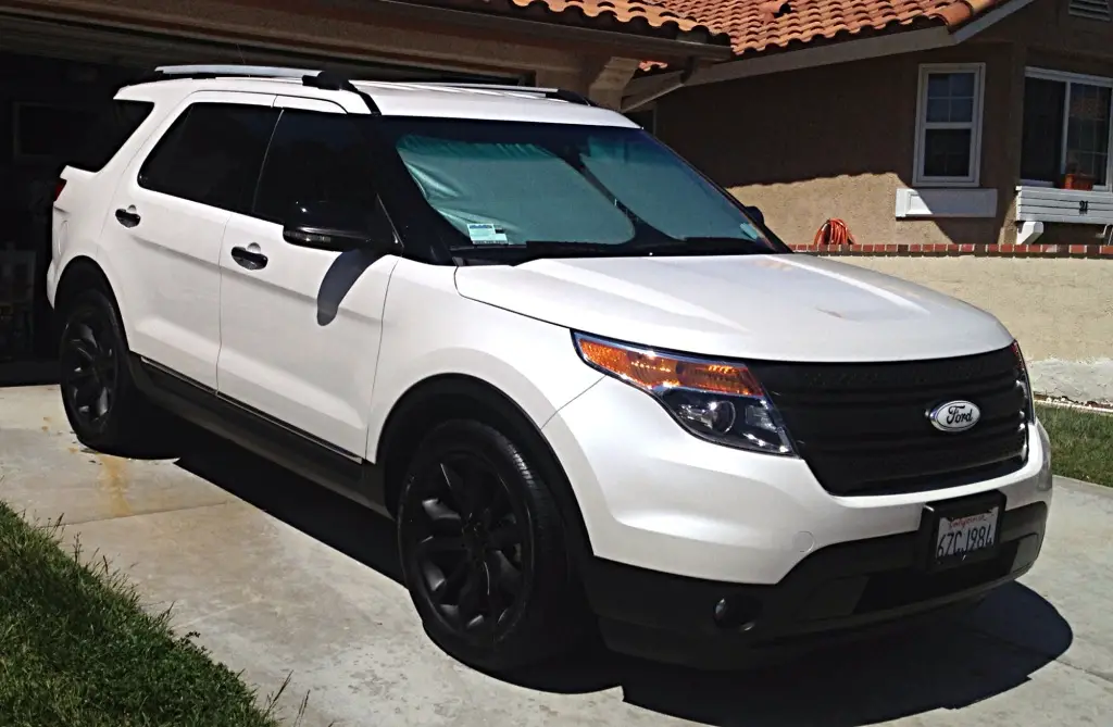

Did this a couple week ago & thought I'd share ;)
Where did you get the white ford symbols for the front and back?

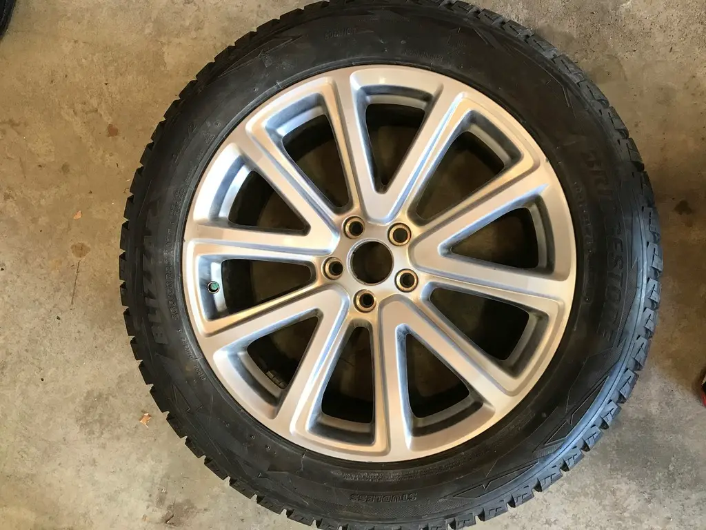

Picked up a 2016 Sport in December, and immediately took it to Discount Tire for new shoes, 265/50 20 Bridgestone Blizzaks. Now I had 2 sets of tires and 1 set of rims. I didn't like the idea of having to spend $60 - $70 twice a year to swap out tires, so I found a set of 20" XLT wheels on Craigs list.
Now the fun begins. Silver wasn't going to cut it, so painted them black.
First, start with a Scotch pad, to scuff the rims. You can use red or green. I used green as it is a little more abrasive and wanted to scuff the coating on the rims. With bare metal, red should be fine.

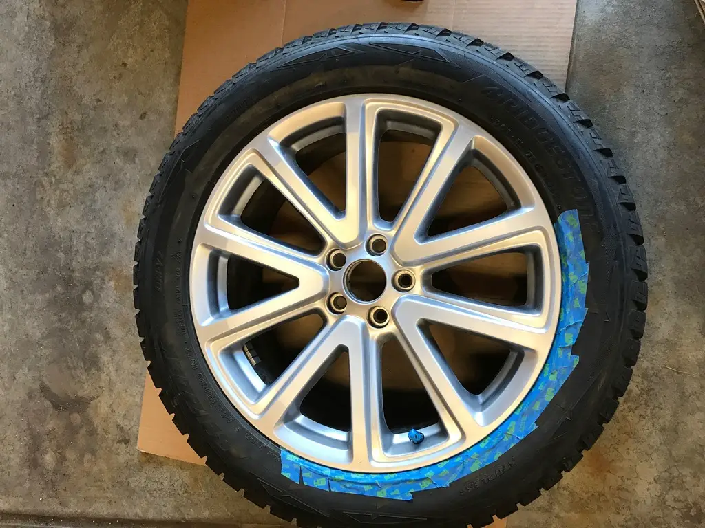

Scuffing and tapping.

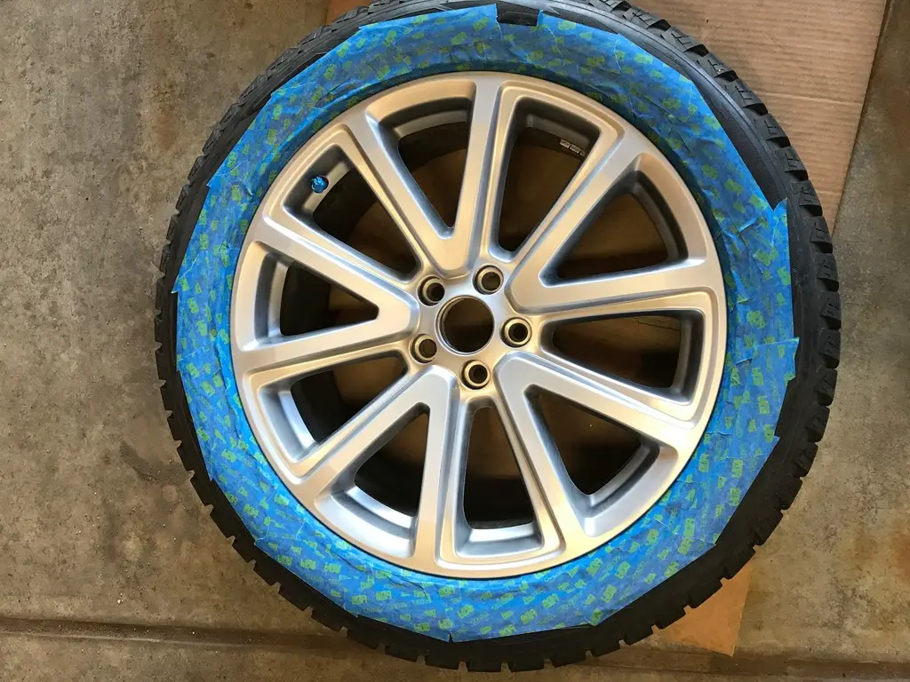

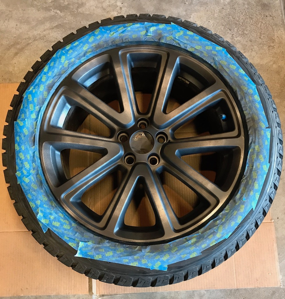

I used 2 - 3" strips and make sure to tuck under the lip of the rim. Also, be sure to tape in the same direction, overlapping each piece, this will make removal much, much easier:
After the initial pass, made a second pass of tape:
Take your time here, the better you tape the cleaner the finish.
Took another 10 mins per rim to tape, 40 mins in.

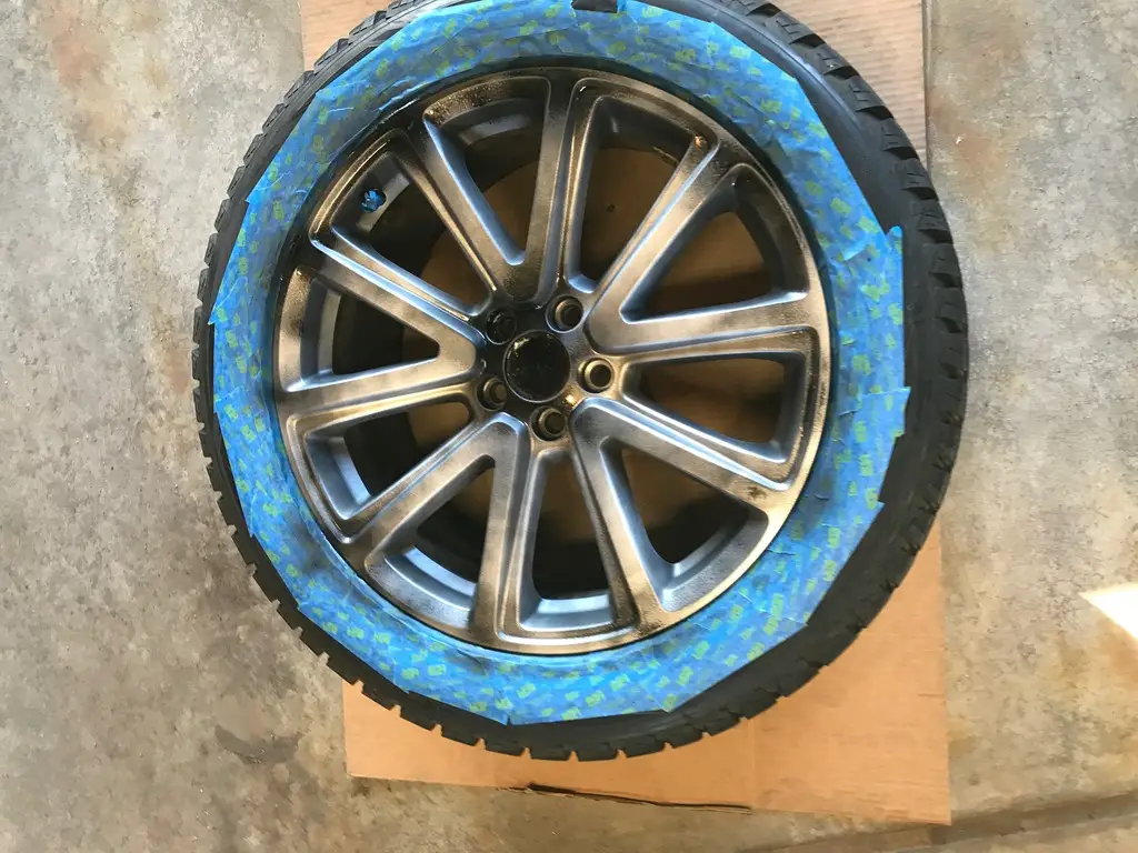

1st coat:
2nd coat:
3rd coat:
You get the idea. Light is aways better than heavy. I allowed paint to dry 20 mins between coats, as it was on the cooler side. You can wait as little as 5 mins in between coats.

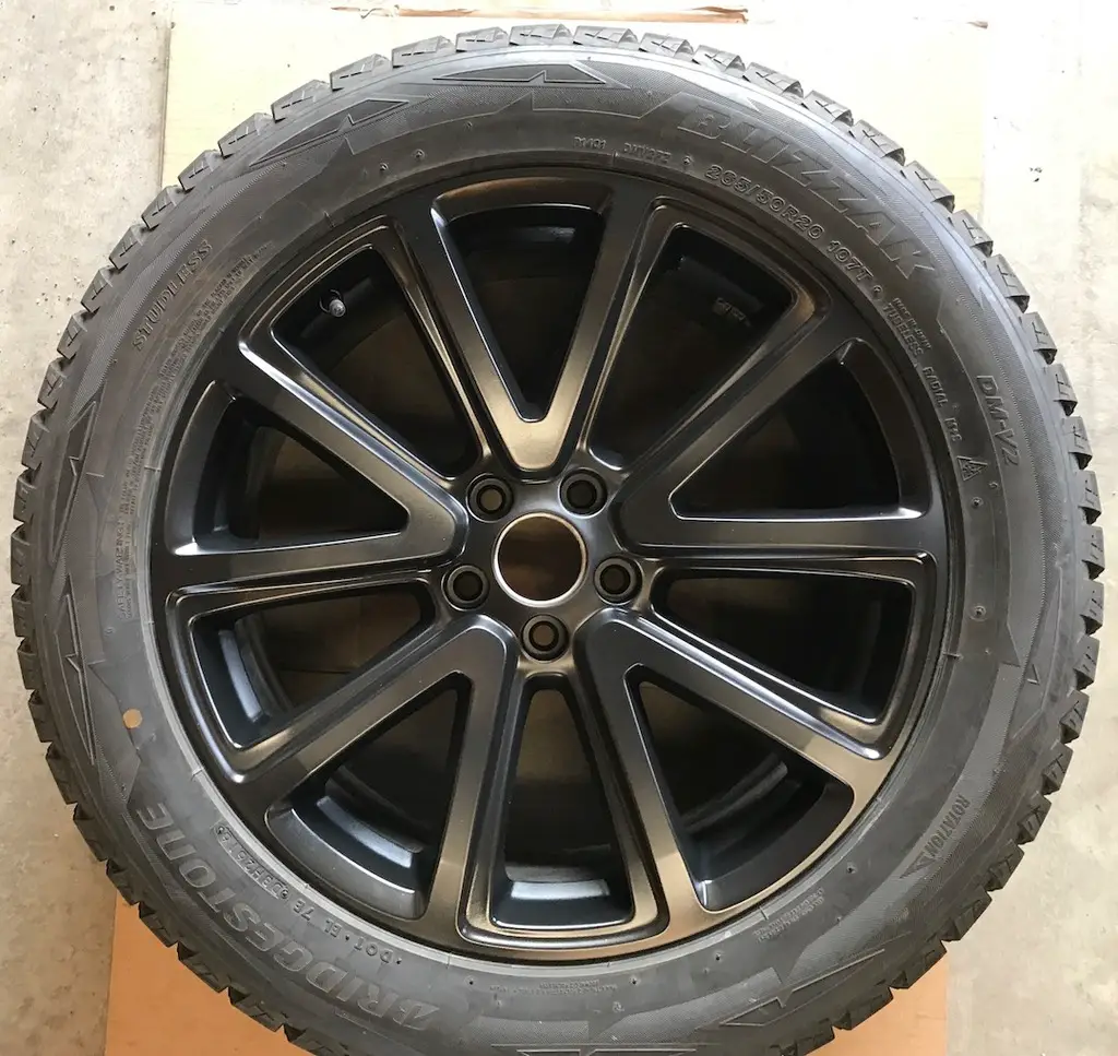

And finally, the finished product:
Now if I can just find some black center caps...hopefully these will work:
Black Center caps
Let me know what you think or if you have any questions.
Just had my wheels changed over from the 18" Winter Blizzaks to the 20" OEM Hankooks and was charged $26.95 which included resetting the TMPS checking tire pressures and using the correct torque on the wheel lugs.
Very nice job BTW.:thumbsup:
