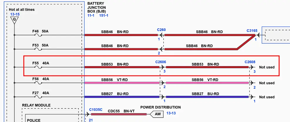

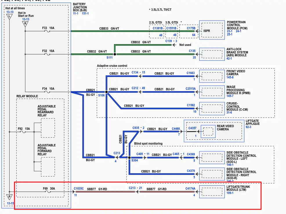

One thing I am uncertain about: there was no wire from the F69 fuse under the hood through the firewall, so I used a wire from F55, which is unused.
What am I doing wrong?
