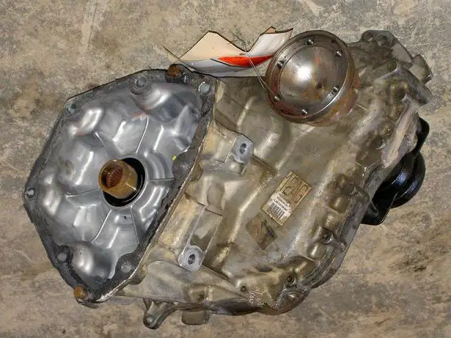

Yes, here is a picture of the BW4410 AWD from 2002+ Explorers. Notice the front mounting pad, it's a huge area that mates straight to the trans. You should be able to see that same large mounting area on your 2WD trans rear housing.

It was taken out in less than 3 hours & everything is truely bolt on, NO electronics. I didn't think it was too bad, remove rear tranny tail, bolt on transfer case, bolt in front drive axle, bolt in front & rear driveshaft, & slide in the front 2 axles, bolt to hub & off you go, I thought it was pretty straight forward, for once Ford made it actually easy to do something.
