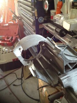

I had to severely gut a stock 4.0L OHV power steering bracket to get the adapter and PSC Saginaw-style steering pump to fit. Should hold up though, I hope.
