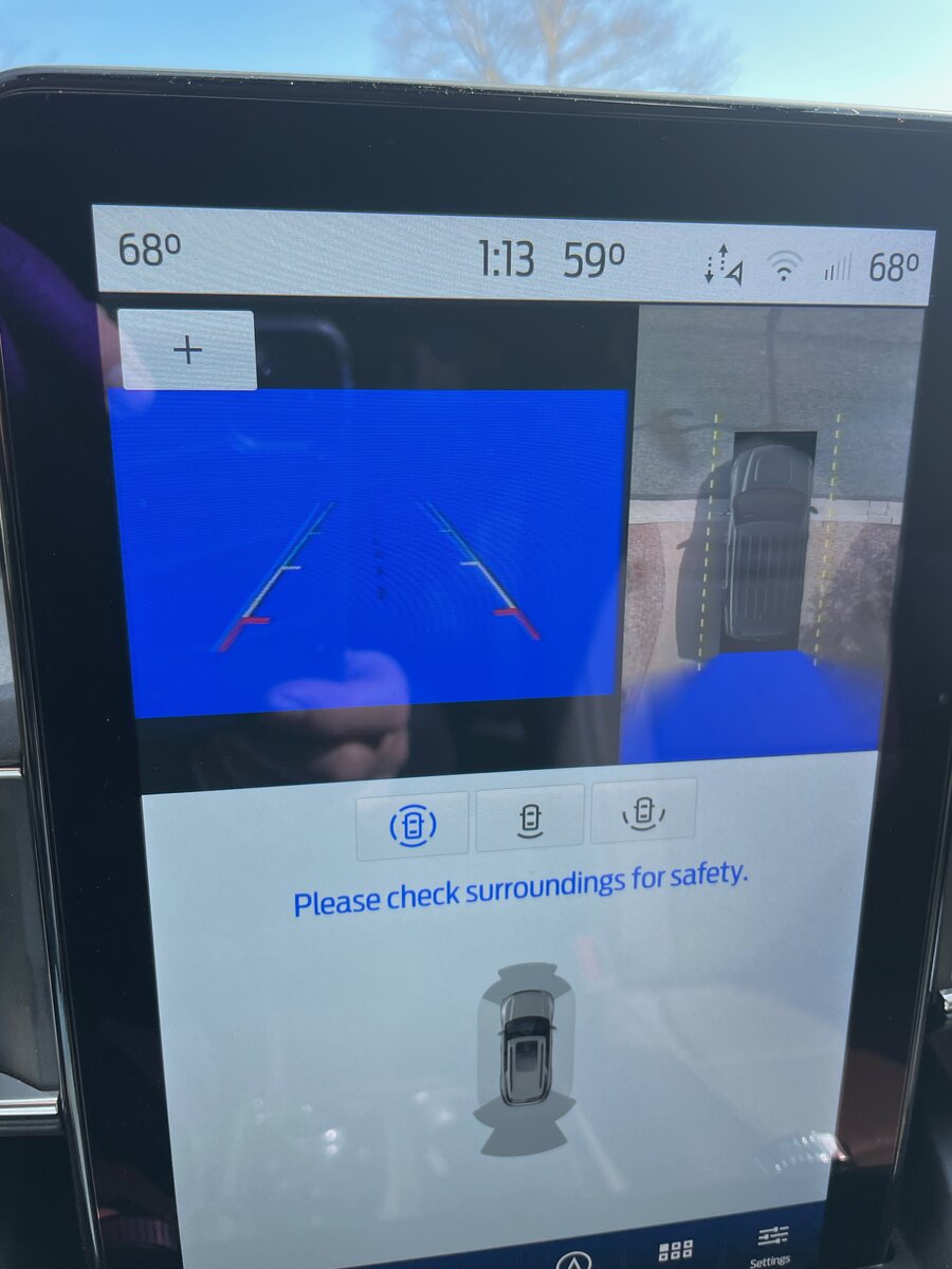

Here is what I am getting now that the recall was done:
6B9DC511-89D7-4362-9BA7-018172D538F5.jpeg 6E28013C-E75B-4D5A-9046-9EA169E3C6AA.jpeg
View attachment 426295 View attachment 426296

The 2020 Platinum went in the dealer today with a printed proof sheet showing a number of photos of the Sync screen main display, showing the blue screen and reverse brake warning failure multiple times during the last 2 months. Dealer was appreciative of the documentation and replaced the rear view camera. All is well now.
