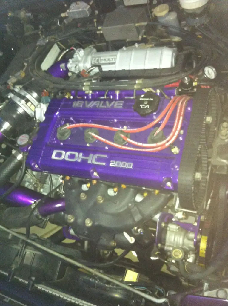

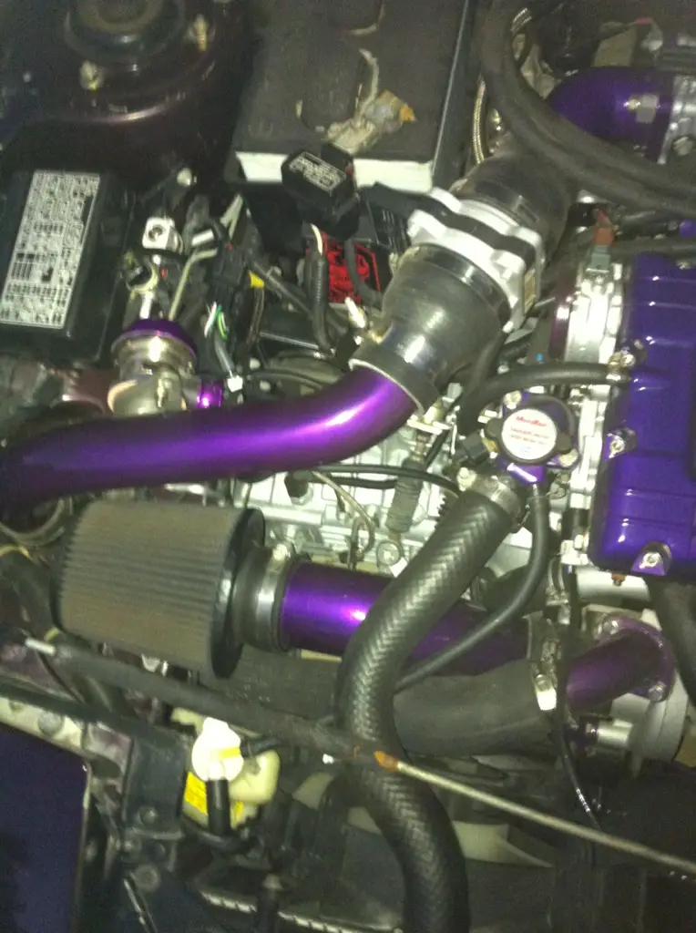

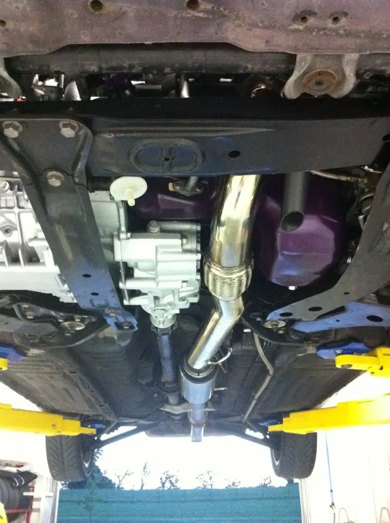

its a 1991 Eagle Talon TSI -AWD 5 speed Turbo
its my little street dominator that my uncle and i built, not bad for a 2.0L! pushes 20lbs of boost right now, its got street cams that give it a nice lobe when at idle. bigger turbo, and too many mods to list.

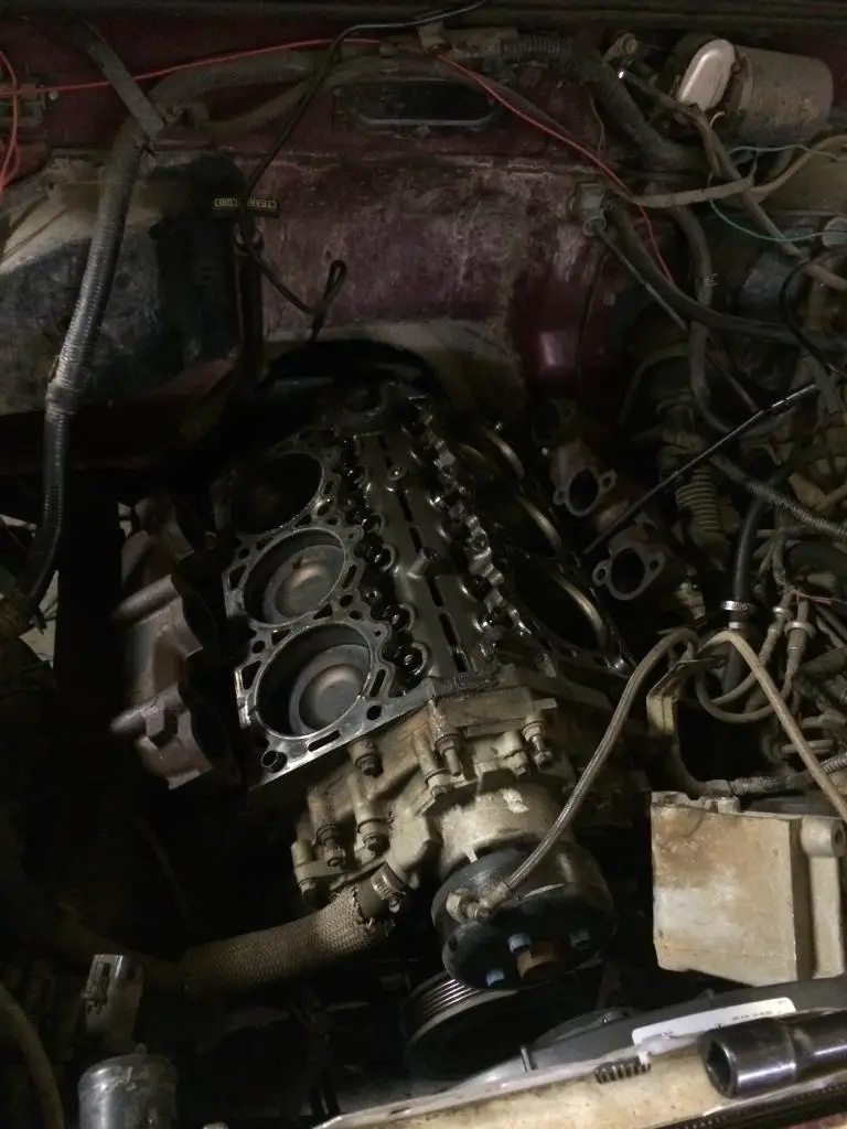

picked up a few good heads from the local salvage yard. lapping the valves right now and hopefully they can go on in the next week or so.

IT HAS STARTED!
as some of you may know, i have been having oil consumption issues for the last 10k miles of my engine rebuild. the rebuild only has about 25k on it now.
due to symptoms i determined that my valve guide seals became worn out due to my rocker arms not sitting flush over the valves. long story short here is what i discovered.

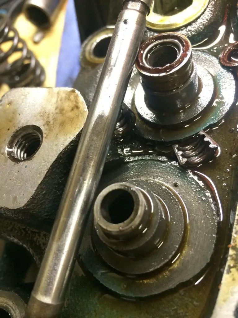

WOW, now the question is, what caused this to happen to every single exhaust valve guide seal??
literally all of them are like this if not worse. all of the intake valves are just fine. now keep in mind, these heads are NOT OEM heads. they are new castings made from a cylinder head company in florida - Odessa cylinder head i believe.
notice the valve guide seal...
and again here. see how its been smashed? these guide seals are also very brittle.
also notice the wear spots on the valve stem.

NO MORE SMOKE!! Gotta love it when things go as planned. First start and she fired right up. Zero problems and no more oil consumption. In the meantime I will be on the hunt for 4.10 or 4.11 gears to swap out. This will be my daily again, now my 1991 turbo awd Talon be the autocross car. Stay tuned.
