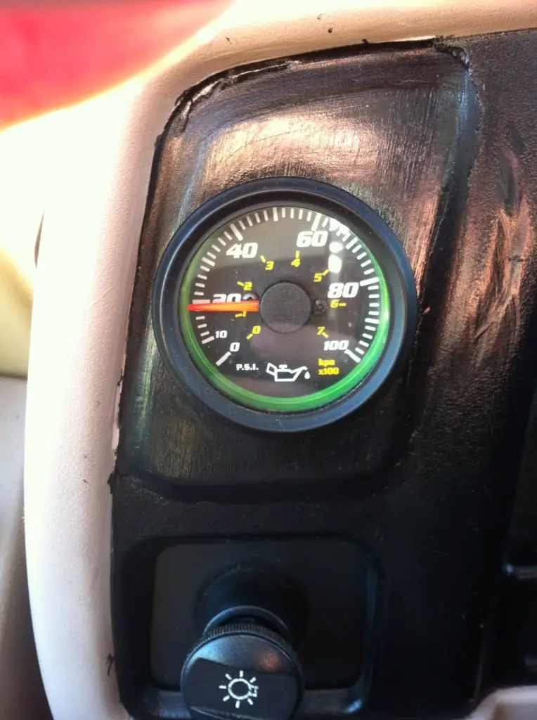

my oil pressure seems to be REALLY low. on a cold start my cheapo mechanical gauge tells me its making 50-60 lbs of pressure, not bad. then once it warms up it goes down to about 12 lbs at idle, bad. i cant quite determine if its the gauge or if its the oil pump itself. ill try the gauge first and of course im kicking myself now for NOT changing out the oil pump for an aftermarket one...

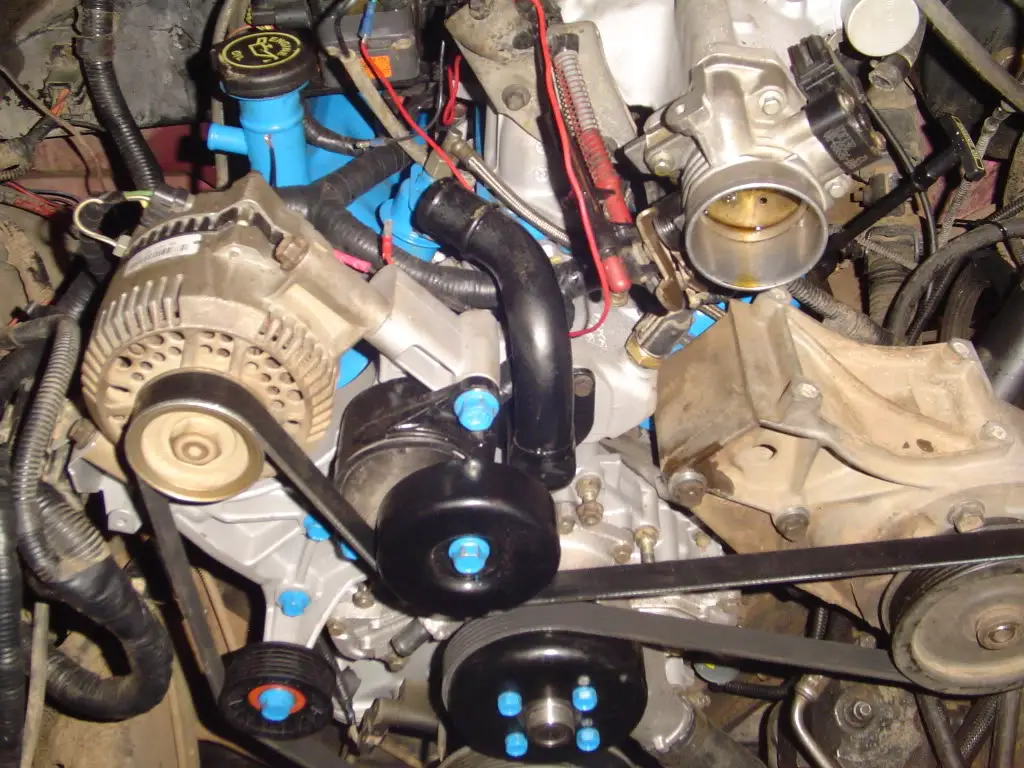

ok. well i got some stuff done....this next pic is for you Xeek.

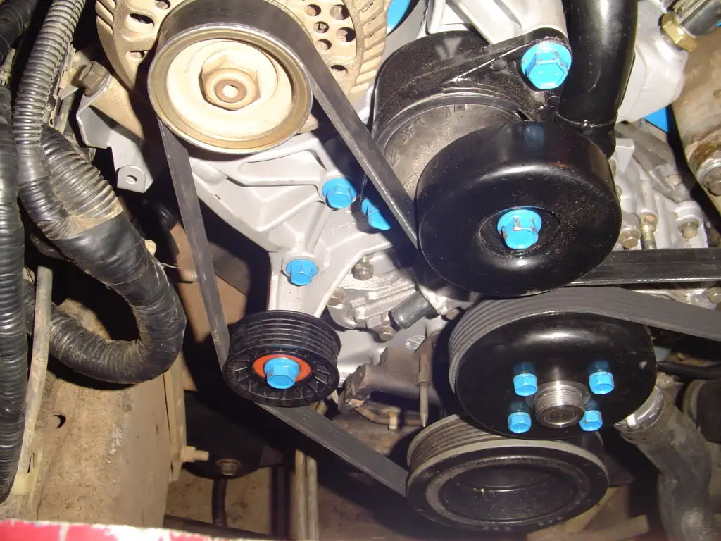

pully should work. belt doesnt seem too tight either.

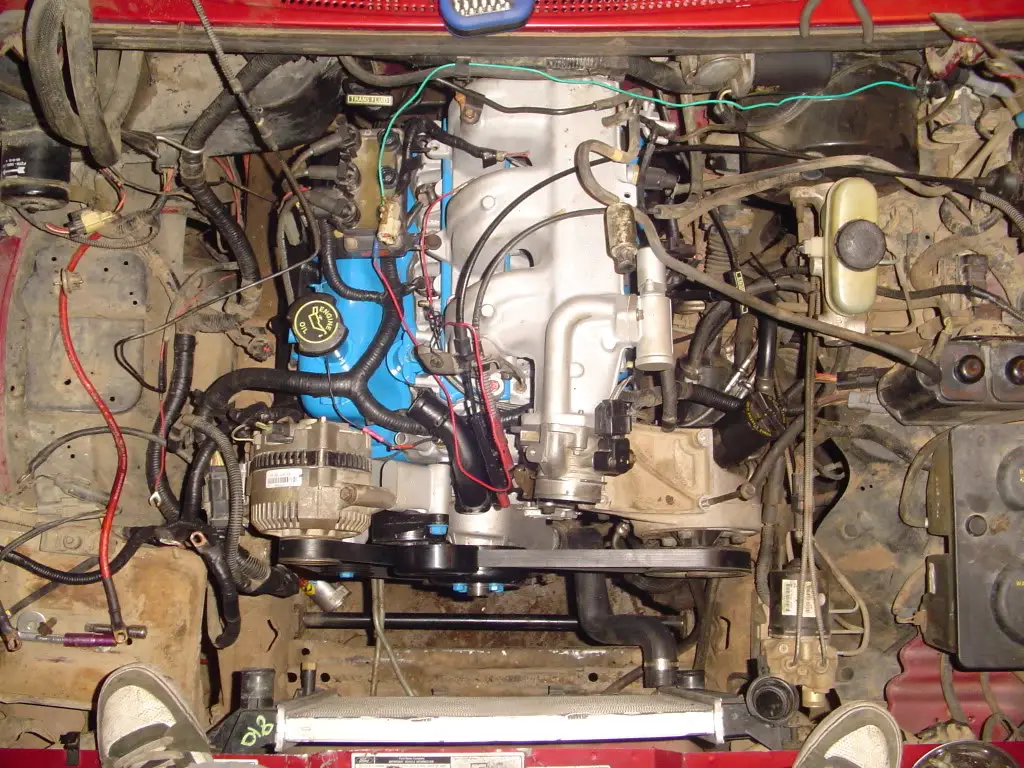

look at all that room! only thing else that i will be adding is the factory air box with a little mod im doing.

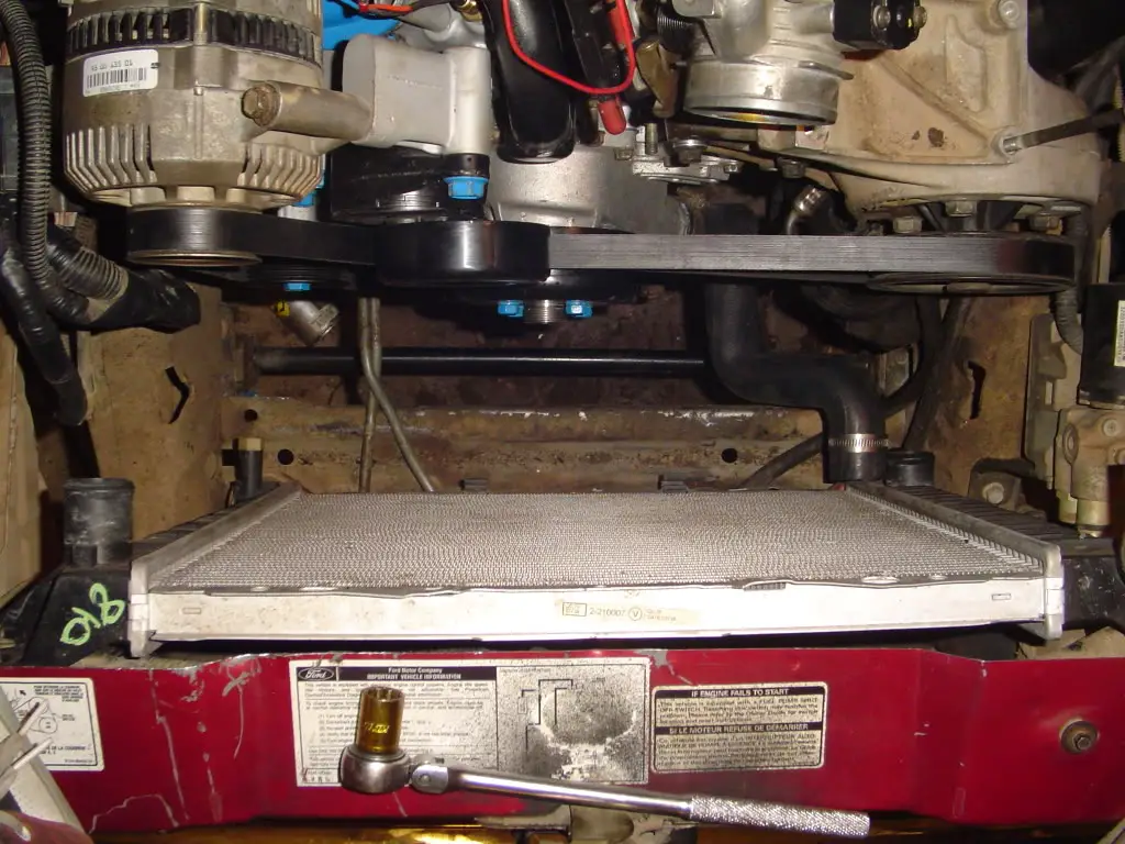

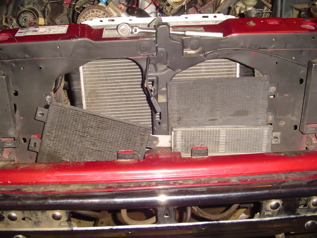

this is my experiment for the cooling system. im using a 4.0 manual trans radiator. only difference is that is a single core design which means the transmission lines that go into the radiator are cut and modified. meaning, that my engine and transmission fluids will no longer be fighting each other to warm up or stay cool. i have two trans coolers in the front.
im surprised someone hasnt tried this already. ill also be using an HHR fan and ill see how that does.
got the motor fully bolted in, wiring harness all plugged in, exhaust Y pipe bolted in and a few other random things.
major items still on the list are the electric fan, my air box mod, electronic accessory wiring
if i was you i would get a trans temp gauge.just those two coolers up front might not keep it cool enough when wheeling.also that is when the hhr doesnt keep the motor cool enough.i run a manual trans custom alum radiator with the ac radiator as a trans cooler,an aftermarket trans cooler all most the size of the ac one and the stock front trans cooler.a4ld HATE heat.great build so far though,looks sweet:D
mine gets low too but thats why i tell everyone to use the hv mellings pump.that cam makes the valve train even louder.also why would you do only a 410 cam,should have went 422.if you think it pulls with that setup you would have loved the 422 and 95tm heads!!! 50 is pretty big to bore it out to but the first gen 90tm block will handle it all day as long as you dont use nos or go FI
i only did the 410 cam because it was the easiest and most practical option, trying to find 93 gas here is a joke and i didnt want to mess with more machining and dual valve springs. im totally happy with what ive got now, anything is better then two cracked heads....
i am running a trans temp gauge, the B&M kit. and its actually MUCH cooler then when i had the trans running thru the radiator. temps stay around 100* all day long, as for the chev fan...its ok...this summer in 110* heat it ran around 200 or 210* and this winter it ran around 180-190. your trans temps must be in the negatives with all those coolers!

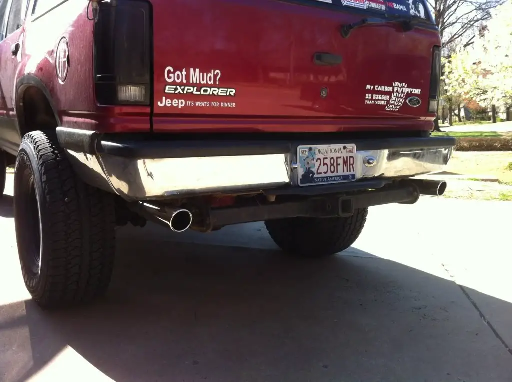

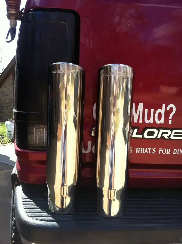

Took these last night after driving around town for over an hour
Duals! split after the flowmaster 40 series. And some mangaflow tips. Sounds great with the comp cam and the other mods

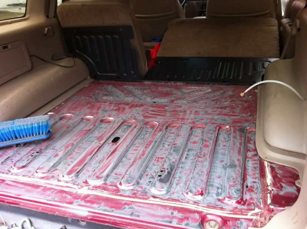

i noticed that i had some water under the carpet in the back as well and it started to grow mold. so i fixed it.
then went the whole 9 yards.
then went the extra mile.

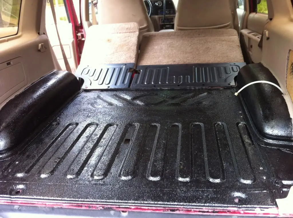

thats only 1 coat of Herculiner. im actually waiting on it to dry now so i can go ahead and throw one more on there. so far i like it!

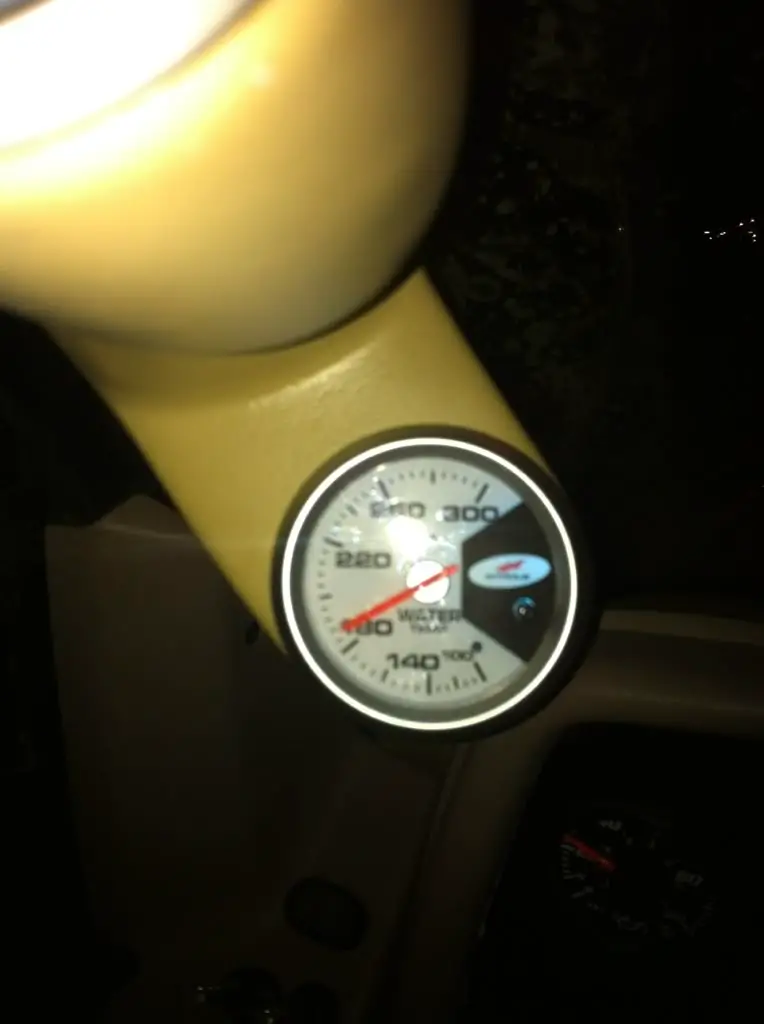

But I changed out the Tstat to a mr.gasket 160*. Runs so much colder now, the HHR fan keeps it cold. This is what my temps are like on a 65* day
And due to the colder temps, this is what I run as oil pressure now
And on a hotter 80* day it has yet to push 170

hahah thanks man, the only thing i dont like about it...is under a load around 1600-1900 rpm it sounds too nasty. im thinking about going to a super 44 to hush it a bit in that rpm range. however, i really love how it sounds at idle. almost like a 302...
