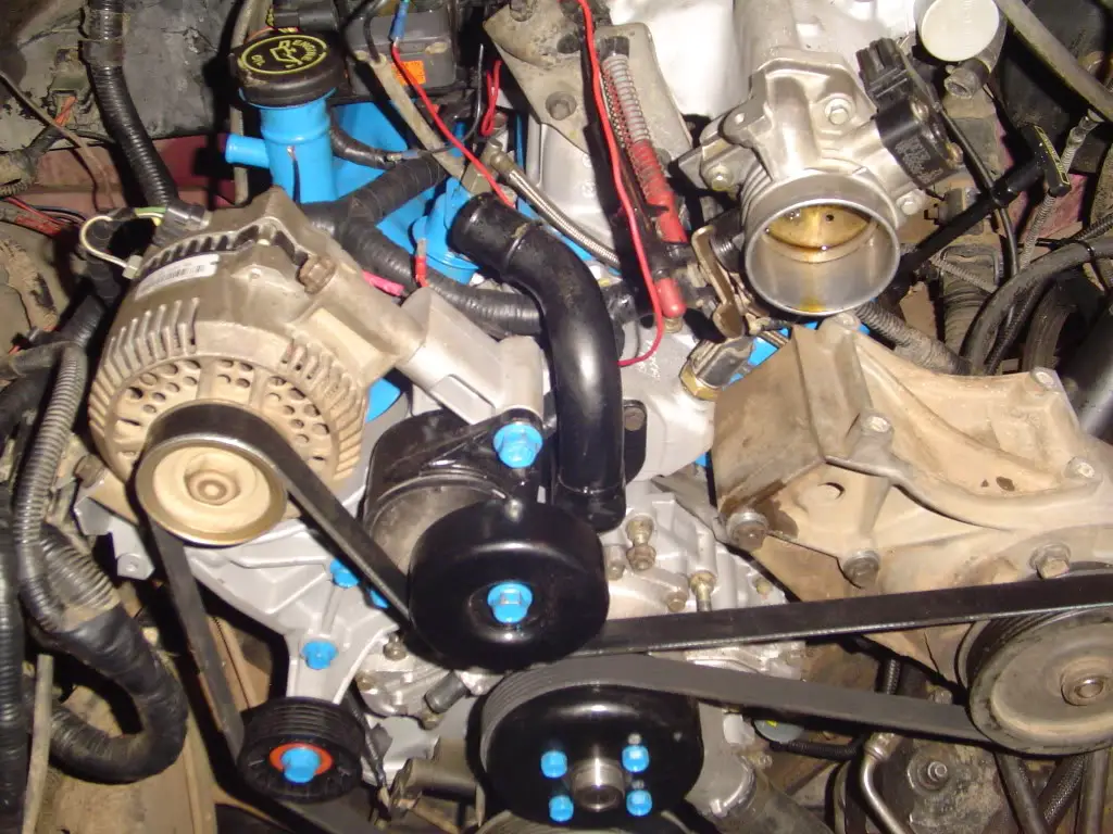

ok. well i got some stuff done....this next pic is for you Xeek.
pully should work. belt doesnt seem too tight either.
look at all that room! only thing else that i will be adding is the factory air box with a little mod im doing.

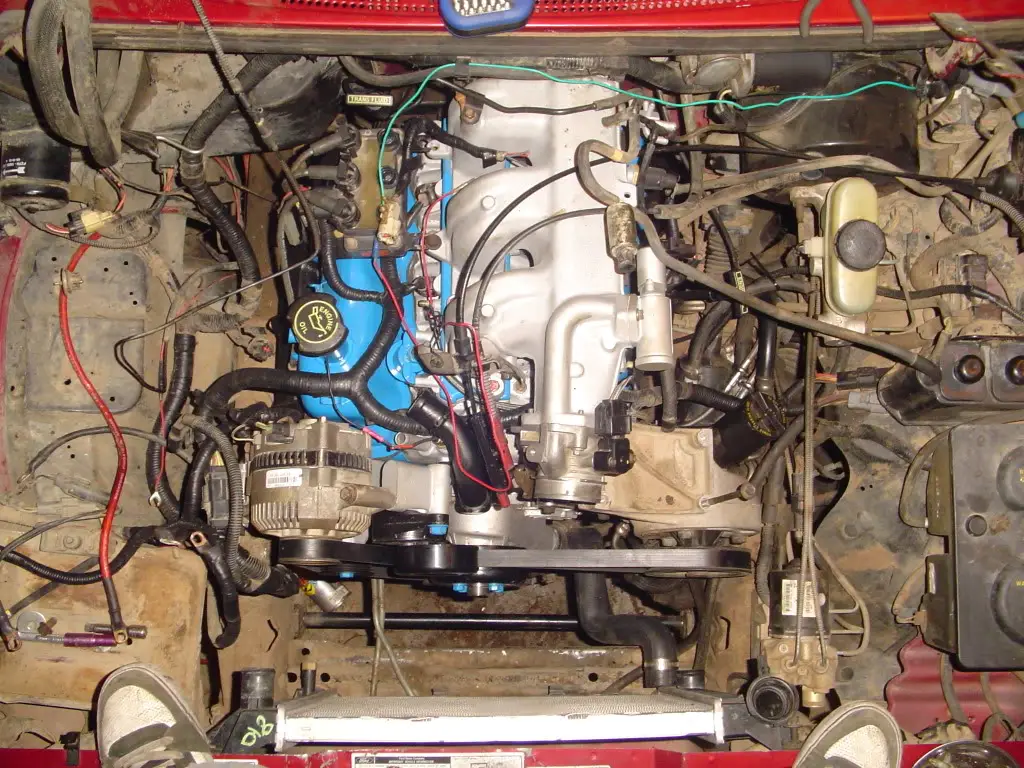

this is my experiment for the cooling system. im using a 4.0 manual trans radiator. only difference is that is a single core design which means the transmission lines that go into the radiator are cut and modified. meaning, that my engine and transmission fluids will no longer be fighting each other to warm up or stay cool. i have two trans coolers in the front.
im surprised someone hasnt tried this already. ill also be using an HHR fan and ill see how that does.
got the motor fully bolted in, wiring harness all plugged in, exhaust Y pipe bolted in and a few other random things.
major items still on the list are the electric fan, my air box mod, electronic accessory wiring

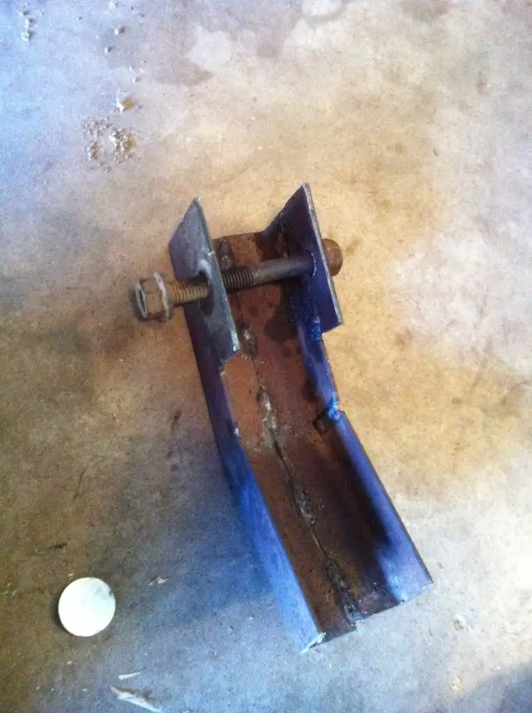

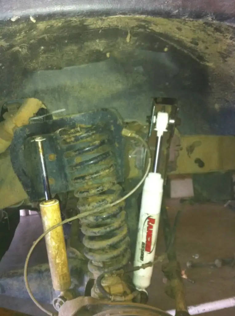

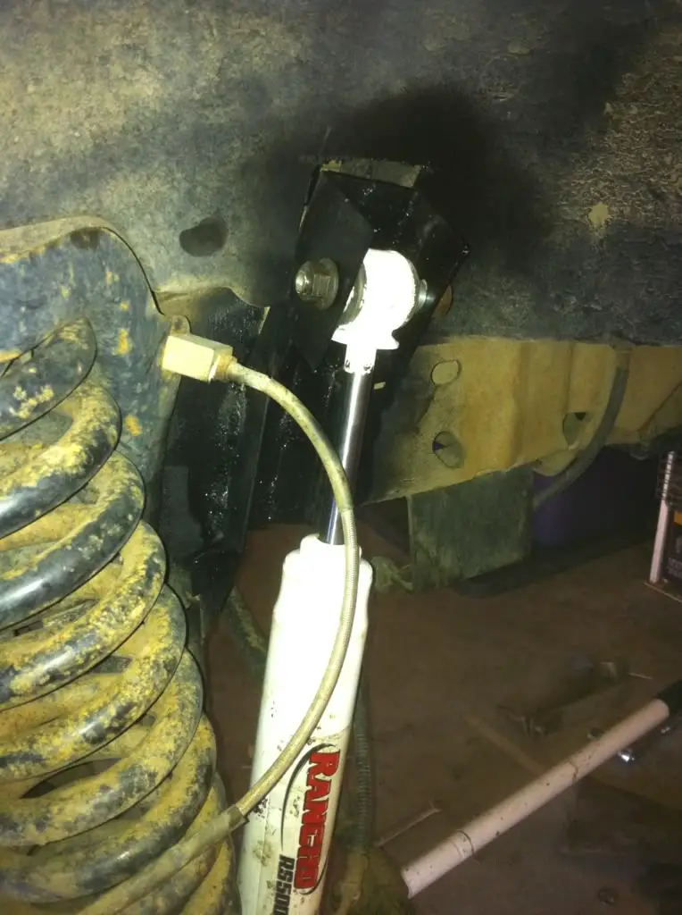

Slight update...traded a badass Jack Daniels belt buckle for two Rancho 5000 shocks. Threw those upfront with a little custom made shock mount I made. Used the existing sway bar bracket for the lower mount. Here are some pics...
Next ill work on getting those RC shocks outta there...
WOW adding new and better shocks up front makes a HUGE difference in steering, ride quality, and the "swaying" back and forth while driving. this was well worth the time and effort. why didnt i do this alot sooner???
