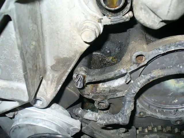

ok so I busted one of the studs holding the water pump on.
attempted to use an easy out, with no luck.
granted, may have been due to cheap bolt extractors.
what other options are there?

I take it its one of the 4 that go into the block and not any of the ones just in the timing cover. Is it broke flush with the block or does it stick out some?
I believe it goes in to the block.
one of the upper-left studs.
there is about an inch sticking out but... attempting an extractor split it apart...
Heat that sucker and squirt some penetrant on, heat again and re squirt. Then try vice grips clamped tight, try to turn the bolt in a bit more clockwise, this may break the bolt free enough to get the counterclockwise rotation going. You might even try to use a hammer to tap it a bit clockwise. EVen if you can get the bolt to wiggle a tiny bit the battle is won. Be patient so you do not damage the timing cover.
Another trick, you might hit the stud with a welder. Weld a nut onto the end of the broken bolt. That way you'll get a nut on it, and, the heat from welding may be enough to break the rust free.

if you can't weld a nut to the end of the broken bolt, some heat and penetrating fluid. plus hit the end with a hammer as well if you can before turning it. not very hard, but hard enough.
put some PB on it already a few times.
haven't tried heat just yet... small propane torch be sufficient?
might need to remove the accessory bracket holding the alt, idler, and tensioner pullies to get sufficient room for a pair of vice grips. not quite enough room for the vice grips I have.
this is what I have left to work with
