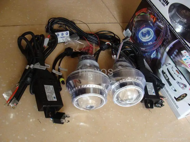

These look to be the same items offered by rsi-hid.com for only $99. Might be worth a shot.
Very late response on my part, but those are complete garbage compared to actually retro fitting some fxr, ls430, or tl oem projectors. The oem are made for HID and you can get bulb spacers and clear lense swaps much better performance and not cheap looking, you get what you pay for with auto parts, please checkout http://store.theretrofitsource.com/ Matt is awesome and very knowledgeable. They have awesome prices if you'll diy. I've done a lot of research on this, NO ONE makes aftermarket projectors for 06 and up explorers...I've contacted manufactorers too and they aren't doing anything and have no plan to right now. There are, however, some after market fog lamp projectors on ebay for 06 and up explorers, but they're for halogen h3 bulbs, yes you could do hid but the projector was made for halogen light so performance might not be that great. but its an option. I plan on doing the retro but I'm waiting till the begining of the year, so when I finally do it I will post pics, lots of pics....including beam patterns..you can checkout beam patterns at the above website ans see what I mean, they even compare oem vs oem with clear lense swap, HUGE difference....
$100 value projectors should be "not as good" as $300 - $400 projectors.
As noted either will probably be better that OEM lights w/glaring HID.
People can only do what they can afford....But thanks for the info.;)
