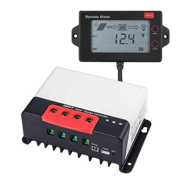

I haven't found any flush mount controllers that will fit in that space, but I did find one from Bouge RV that has a remote display. I'm sure I can make the controller fit behind the panel, with the wired remote mounted to the front of the panel.
I'll keep looking for controllers, but think that is the one I will be getting. Should be back in San Diego next week so I can order one then.

Now, I'm looking at solar chargers I can mount in the basement storage with a cabled remote display/control. I'm not interested in Bluetooth, want a actual physical connection between charger and panel.
EPEVER MPPT Solar Charge Controller 40A 150V PV Solar Panel Controller Negative Ground W/ MT50 Remote Meter + Temperature Sensor PC Monitoring Cable[Tracer4215BN] https://a.co/d/2AZXG0G
EPEVER 40A MPPT Solar Charge Controller 12V 24V Auto, 40 amp Negative Grounded Solar Charge Controller MPPT Max Input 100V, 520W/1040W for Lead-Acid, Lithium Batteries and Load Timer Setting https://a.co/d/hV4Clt3

I think I'm going to purchase this charge controller. It has good reviews, and I've also watched a half dozen comparison videos, and this one is always in the top few.
EPEVER MPPT Solar Charge Controller 40A 150V PV Solar Panel Controller Negative Ground W/ MT50 Remote Meter + Temperature Sensor PC Monitoring Cable[Tracer4215BN] https://www.amazon.com/dp/B07429RK43?tag=seriouexplor-20
There are a few Victron Energy units that I also like, but would then have to purchase a separate battery temp sensor, displays, etc. It uses Bluetooth for monitoring, which I don't want. It appears the controllers that have optional displays are $450 and up. Victron makes nice stuff, but I don't want to spend $800.
The deciding factor will be when I run a fish tape marked at two meters, from where the display needs to be located to where the controller needs to be, because the data cable for the EPEVER display is only two meters long. I think it's long enough, but need to be sure before I buy one.
