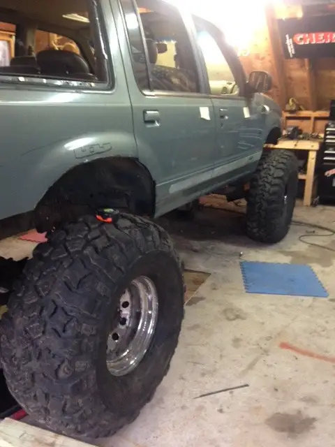

wheel base hub to hub is 114"
vehicle: 97 explorer limited 5.0
what its getting.
rear SRW full float 14 bolt
5.13 spool
front is a ford dana 60 hp king pin 5.13
lock right

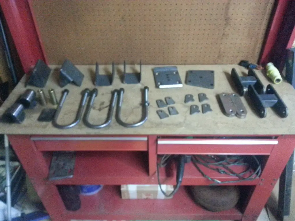

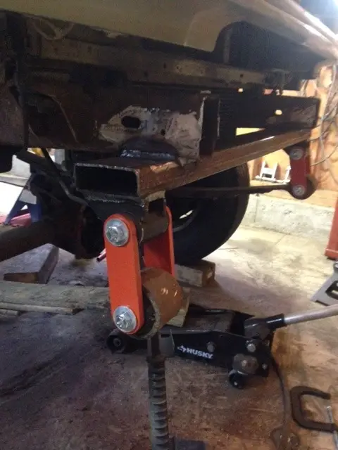

rear springs are stock with a yj long leaf and a 2" add a leaf
and 2" shackle
soa
front is soa
dodge ram 1500 rear leafs
with full length fab tech add a leaf
NP 205 twin stick
