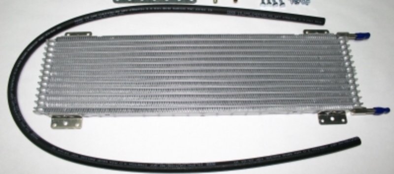

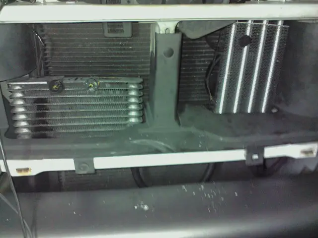

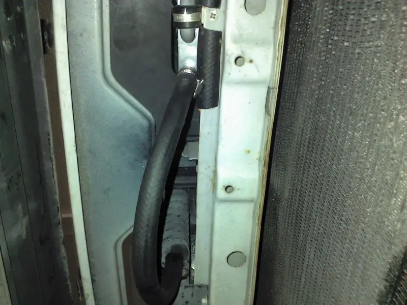

I have started doing allot of towing with my Monsterneer. The limiting factor for towing (heat wise) has started showing as the transmission. I have a pretty tired 5.0 (190K miles) in it now, but in the next year or so I am looking to put a hopped up 347 in it. That will really heat things up. The trans can easily get going north of 230°F climbing hills while towing my 4000 pound trailer. It has the factory towing package with the cooler in front of the radiator.
I also have a 9000 pound winch "hidden" in the bumper. I am looking for any other alternative auxiliary cooler mounting locations. What have you all been doing?
I have seen the posts by Aldive and the others that mounted a second trans cooler to the drivers side of the original one. That is what I am considering for now, but I would really like to mount a remote one with a fan on it.
