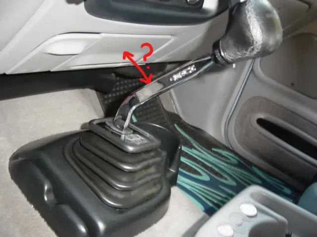

Could someone with a 2nd gen with the Hurst shifter do me a favor? Could someone measure from the face of the ash tray with it closed to the back of the sift lever about 2" above the bend with the shifter in 3rd gear?
Thanks

Under the inner boot is the same as factory. The section you see, bolt directly to the top of the tranny the same was as the factory shift. Just uses longer bolts.
