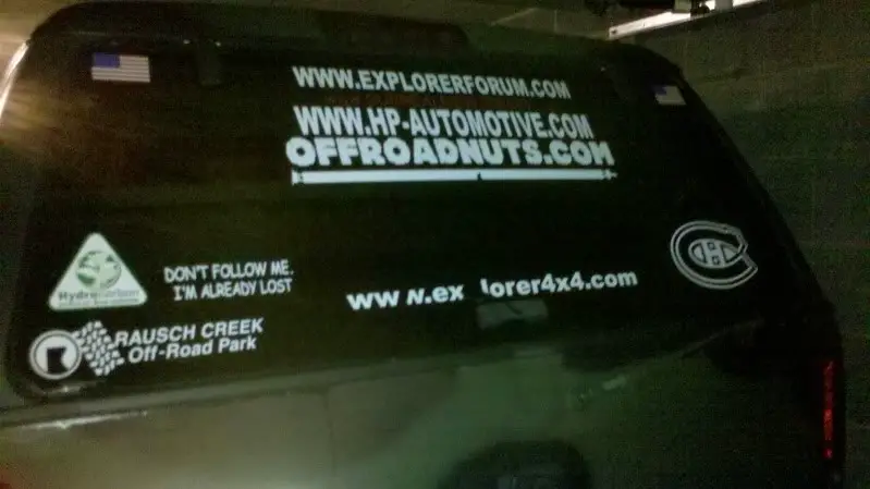

im a devils fan first and formost, but i have ties to the habs in the form of gionta, so it stays... that and i know how much tara loves it....
dam looks like i missed out on a nice vinyl
