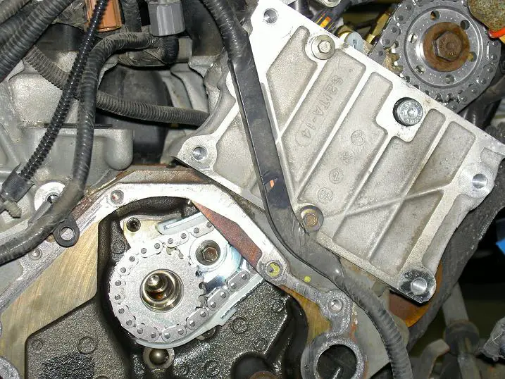

On another subject, I am uncertain which way the jackshaft front camshaft chain sprocket should face. Does the smooth face of the sprocket face away (as shown in the photo) or toward the block? I haven't been able to find any photo of the jackshaft camshaft chain sprocket without the jackshaft primary chain sprocket in the way.

Here Dale, I re-sized this and put it in my project file. In one picture I can read the word ITALY on the links. I don't recall the gear being different on ether side, I can see the number 04 on this.
By looking at the picture posted by CDW6212, it looks as if Ford had no choice but to build the guides with deflection on the traction side. It looks as if the path the chain follows is curved and not straight. If these guides have lated for 150,000 miles, I expect the new improved guides should last even longer.
Thanks Don. That's exactly what I needed! There's a recessed area near the center on the back side of the sprocket probably to mate with the jackshaft. I guess I would have been able to figure it out upon reassembly but I like to be certain.

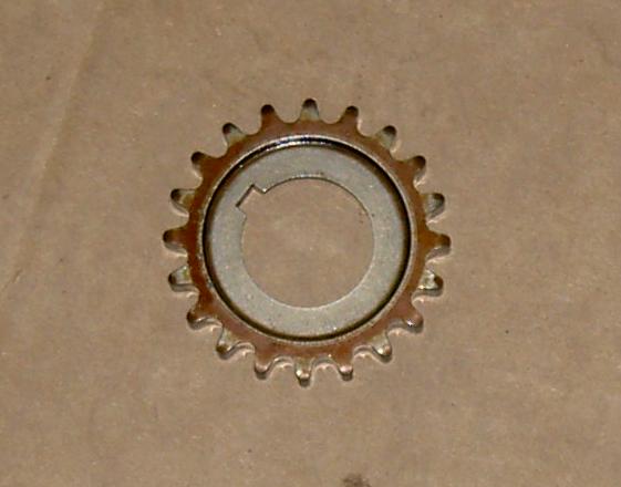

Very good. You have already noted that the crank pulley goes on with the dots on the back? My early pictures of my thread show it backwards, I hope it doesn't confuse anyone. Don't flip it so the dots are visible, the balancer will end up out 1/8" or so. I learned that the hard way.
These are the front and rear of the crank gear.

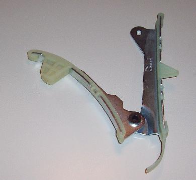

StreetRod, have you removed the front left guide? What condition was it in?
The traction side is on the exhaust (outer) side of the head for the front cassette. There is very little curve to it as shown in the photo below.
Since it is fairly straight, as the guide chain contact material wears the relative timing between the jackshaft and the camshaft does not change.
The slack side is the side where the hydraulic tensioner contacts the guide and keeps the slack side of the chain from slapping.

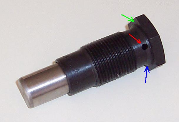

I ran into 2 problems. One is neither of the new Ford tensioner for the heads have washers. When I removed mine, the front one had on and the rear did not. Aside from possibly leaking, I don't know what issues I would have from not installing a washer on the rear.
My stock configuration was the same as yours. I suggest you install the rear tensioner without the compression ring. The oil pressure port on the tensioner is very close to its hex head inner face as shown in the photo below.
The thickness of the compression ring might partially block the port. I would torque to 49 lb-ft.
