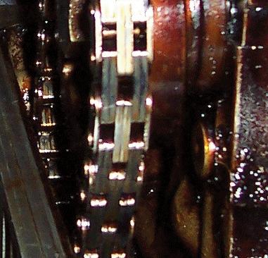

The photo below illustrates why it is necessary to remove links in multiples of two when shortening the timing chain.
One link consisting of two sections of two metallic strips is attached with a pin to the next link consisting of three sections of strips - single outers and double middle.

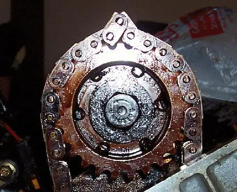

I realized today that I can determine if removing two links is possible without taking apart the chain. A single link of chain corresponds to one tooth of the sprocket. So I installed the jackshaft and loosely attached the old rear jackshaft sprocket and chain. Then I just installed the chain on the camshaft sprocket shortened one tooth as shown below.

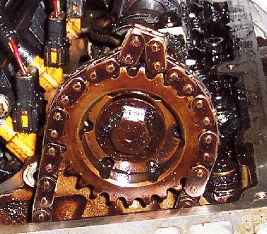

Next I tried to install the camshaft sprocket with the chain shortened two teeth (two chain links) as shown below.
Even stretched taught and with no guide assembly I could not seat the camshaft sprocket onto the camshaft. So now I'm convinced that shortening the chain is not feasible and I can proceed with assembling the engine using the latest Ford cassette as soon as it arrives.

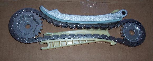

The new rear cassette from Ford arrived today and is shown below.
As suspected, it only included the updated guide assembly, chain, jackshaft rear sprocket and right camshaft sprocket. There were no bolts even though the jackshaft rear sprocket retaining bolt is a torque to yield bolt and should not be reused.
I positioned the components for the photo in the approximate way they are installed in the engine. You can see the significant curvature of the traction side of the guide assembly which has no metal bracket support and has renewed my concerns about installing it.

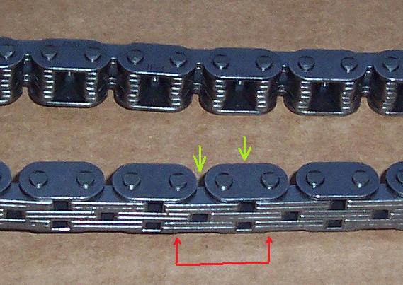

The photo below is a closeup of the new rear timing chain. It was made in Italy like my original chain.
The red arrows indicate the minimum amount (approximately 0.75 inches) that must be removed to shorten the chain. Each yellow arrow indicates a tooth position on the sprocket that corresponds to the shortened chain length. I again attempted to mount the stock chain on the camshaft sprocket with two links folded as shown in a previous post. This time I wired the two links together so they stayed in the shortened position on the camshaft sprocket while pulling the chain taught. I found that the distance from the centerline of the jackshaft to the centerline of the camshaft would have to be decreased by more than 0.25 inches in order for the shortened chain to fit. I suspect that even if I had a thinner head gasket and the head milled a small amount that the sprocket would not mount correctly on the camshaft.

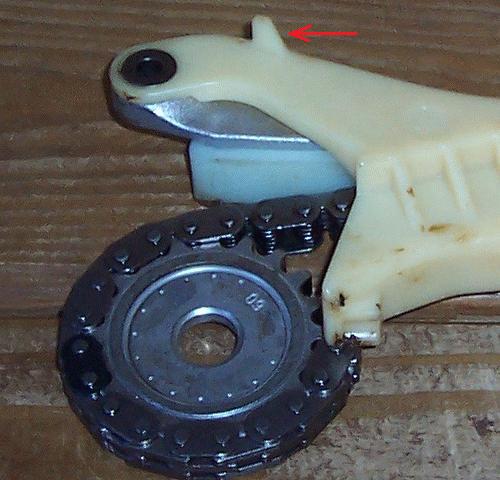

I ran into a problem while attempting to install the new rear cassette into my engine. There is a plastic tab near the lower end of the traction side of the guide assembly. At first I thought it was to keep the assembly in position by resting on a ledge in the head while inserting the guide assembly lower mounting bolt. However, after loosely installing the lower mounting bolt, I noticed that the tab was binding against the head casting and keeping the upper end of the traction side from being in position for the upper mounting bolt. I rechecked the part number (4L2Z6M290AA) and confirmed it was for the Explorer SOHC V6 from 1997 thru 2005. Tomorrow I'll pull the cassette assembly out and look for a notch or hole in the head for the tab to fit in. Maybe it's there and just plugged up with sludge. Fortunately, I did not torque any of the bolts so they can all be reused. I don't remember any of the assembly instructions mentioning the tab but I'll check all of them again. Has anyone else encountered a similar problem?

I pulled the right cassette out and scraped some sludge coating off the head casting. The red arrow in the photo below identifies the tab that was causing the installation problem.
I pushed the jackshaft forward and tried again to install the cassette. After several minutes of twisting back and forth it finally dropped into position. Since I reused the guide assembly lower mounting bolt I was concerned that the O ring might leak so I applied some non-hardening gasket sealant to it. I may have trouble removing it when I rebuild my engine.
