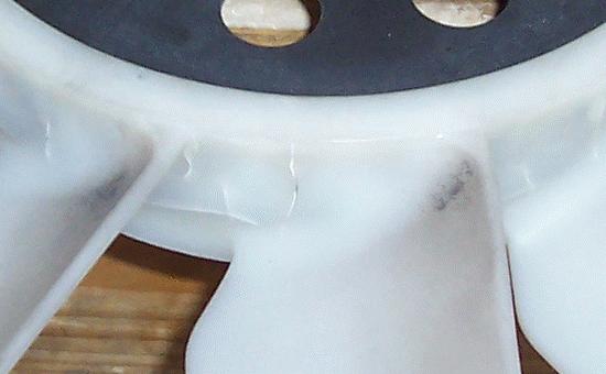

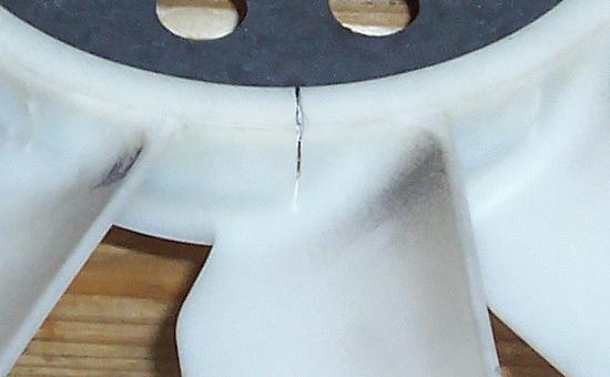

Caution: radiator fan blade
I advise everyone to periodically inspect their radiator cooling fan blade for cracks. See the photos below for the condition of mine.
I received a replacement used fan blade (in good condition) purchased from eBay this afternoon.
Yikes! Had it been making any unusual noise or louder than normal?
Good idea Dale! Mine also had cracks throughout it.
Probably since I bought it
I suspect the cracks have been there since I bought the vehicle a year ago. I'm surprised I didn't notice them when I replaced the radiator. Considering all the times I've approached engine red line while testing my custom tune I guess I've been lucky the fan held together. Thanks to the viscous clutch.

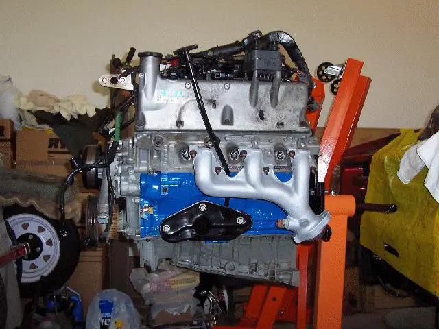

Painting completed
I finished painting the engine block and the exhaust manifolds. The results are shown below.
I may buff the aluminum parts (valve covers, front timing cover, block cradle and heads) when I rebuild the engine.
WOW.......Nice!
I'm going to do the same.

That's a beautiful site :D
I like the Boy blue color then that GM girlish orange:D
