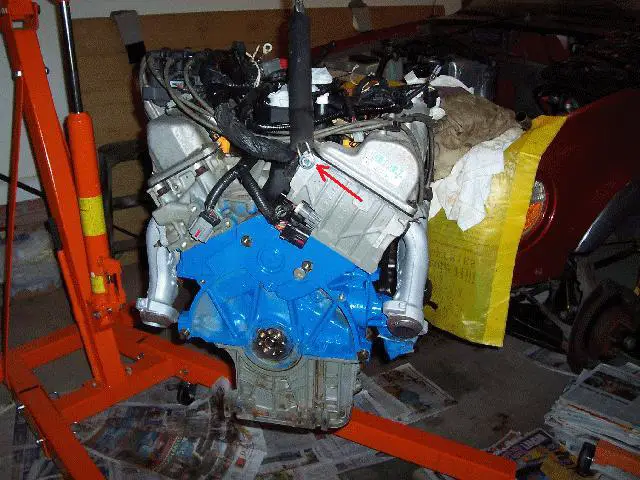

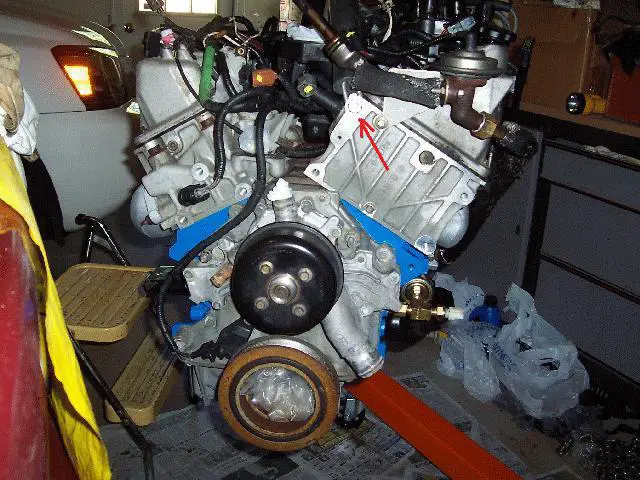

Today I applied dielectric grease to the spark plug wire and ignition pack boots and then installed the wires. It was then time to transfer the engine from the stand to the crane. I began looking for engine lift points that would result in the proper center of gravity and not damage my newly painted exhaust manifolds. I came up with those identified by arrows in the photos below.
CAUTION: It is important to prevent the engine lift chain from slipping in position when the engine is tilted.
Identified by the arrow in the photo below are removable chain links that attach the engine support chain to the crane hook chain. I did not use the actual crane hook. The links prevent the support chain from slipping in either direction.

Dale that looks like good lifting points

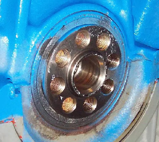

Rear main seal replacement preparations
The photo below of the old crankshaft rear main seal attempts to illustrate that there is a variation in the upper and lower sections of the block where the seal fits.
My Haynes manual specifies that the seal should be perpendicular to the crankshaft axis and that the tolerance is 0.015 inches. Many members have experienced leaks after replacing their rear main seal. I suspect that they may have tried to seat the new seal flush with the nonuniform block surface.

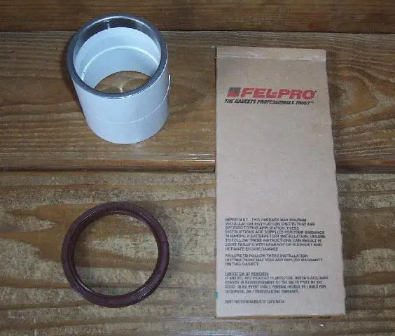

The photo below shows my seal installation tool. It is a 2 inch schedule 40 PVC coupling. The coupling inner diameter is the same as the outer diameter of the crankshaft. The coupling outer diameter is less than desired but adequate.
I used a drum sander to enlarge the coupling inner diameter until the crankshaft sleeve provided with the seal kit fit inside of the coupling as shown in the photo below.
I drilled two small holes where the "dimples" are on opposite sides of the seal. I was careful not to go any deaper than when the drill broke thru the seal. I used a new drill bit so it would not "walk" away from the dimple and endanger scoring the crankshaft. After drilling the holes I inserted two hex head sheet metal screws as shown in the photo below.

Replacing rear main seal

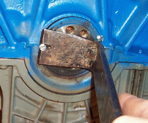

I used a small pry bar as a lever as shown in the photo below.
The old seal was easy to extract with the pry bar.

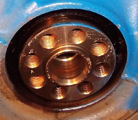

I inspected the crankshaft for wear to determine if I needed to use the sleeve. I found some crud accumulated on the surface but no indentation from the seal rubbing.
I cleaned the crankshaft surface with a thick cloth soaked with solvent folded over the end of a small flat blade screwdriver. I was very careful not to poke the screwdriver blade thru the cloth and scratch the crankshaft surface.

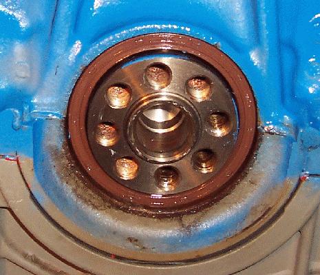

I applied engine oil to the inner and outer surfaces of the new seal and placed it in position. Then I used the coupling and my 4 pound hand sledge hammer to tap the seal gradually and evenly into it's seat. I used the short end of an allen wrench as a "feeler gauge" to compare the distance from the end of the crankshaft to the seal. The installed new seal is shown in the photo below.

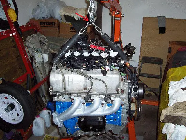

Engine Lifting
Dale,
With this setup you just saved yourself about $315.00 so go buy yourself something nice. :)
attachment.php
Ford Tools
Bob
I'm sure the chain you used has plenty of strength you need to lift the engine. But for anyone out there that wants to copy, please make sure your chain is no smaller than what you see in the picture above. 7/16” ??
I can't help but notice the chain is loaded on 1 link up top. If that link breaks, you’re in trouble...
Now with the other set-up, you're dividing the weight of the engine. Instead of all the weight on 1 link, you have it divided in half which will more than likely take twice the load.
Again, I don't think the 7/16" ?? chain you used is going to snap, but from an engineer's stand point, and a safety look, the other set-up could be worth something if you ever find yourself trapped on the floor with a 4.0 SOHC on your chest.
