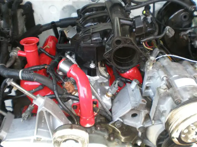

Finishing up installing the new shortblock and the rest of the top end in my Explorer.. I had Turdle powdercoat the valve covers and the water neck in bright red and they really do stand out in the engine bay...I wish the rest of the components didn't hide the valve covers though...I may get a set of brackets and have them and maybe the exhaust manifolds powder coated as well.. Especially if the powdercoat would hold up the heat...

As an ex powder coater (mind you that was over 15yrs ago and now a chef) I am quite sure it wont hold up. Powder coat is baked @ between 180c and 200c,
depending on colour, for 10 mins. Any longer or hotter and it will start to burn and discolour. Any other engine component can be done. Epoxy powder coat is the best as it is more resistant to corrosion.
Ceramic coating is resistant to very high temps but may not be worth the cost.
I think hi temp paint is the way to go. Its cheap and any painted exhaust manifold looks good.

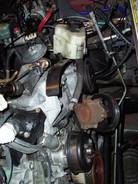

Today I tackled the power steering pump. My goal was to completely disconnect it from the engine without disconnecting any of the fluid lines. I did not remove the water pump pulley or the power steering pump pulley. There are holes in the power steering pump pulley that allow removal of the pump mounting bolts without removing the pulley. I left one of the three bolts in place until after disconnecting the reservoir mounting bolts. I disconnected the hose positioning bracket below the pump but overlooked the one under the A/C compressor that is visible from the left fender well. The photo below shows the steering pump after I was able to work it past the water pump pulley.
There's a plastic pin on the bottom of the reservoir that fits in the mounting bracket. The reservoir must be raised the length of the pin before the entire assembly can be moved forward and down out of the way. I realized there was still a hose positioning attachment in place when I tried to raise the reservoir. The hose has to slide past the A/C compressor before the steering assembly can be lowered out of the way. It is necessary to disconnect the A/C compressor clutch electrical connector to get the hose past. It took me about 20 minutes to get the connector to release because it's not the squeeze type like I assumed. The photo below shows how neatly the power steering assembly can be tucked out of the way.

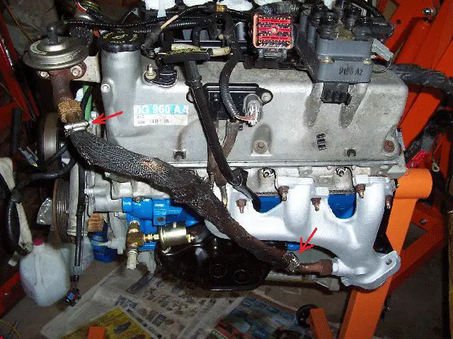

My EGR tube heat sleeving has unraveled a little at each end so I installed hose clamps as indicated by the red arrows in the photo below. The heat sleeving helps the EGR tube retain heat which reduces condensation in the DPFE sensor tubes/hoses.

Too funny! This sleeve is drawn in as frayed and unraveled in the diagram of the EGR tube in my manual.

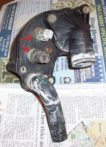

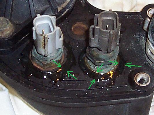

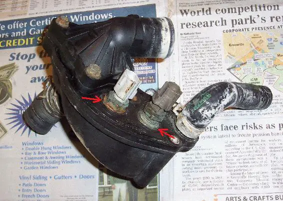

When I installed my 00M12 kit I removed the engine coolant temperature sensor and the engine temperature sender from the thermostat housing to gain more room to remove and install the hydraulic tensioner. I was luckier than some other members who had the brass fitting spin in the plastic housing. When I installed the sensors I used thread sealant to prevent leakage. I anticipate that the thread sealant will require additional force to remove the sensors in the future.
Since I had the thermostat housing out while replacing the timing chain components I decided to try reinforcing the housing. First I cleaned the exposed portion of the brass fitting and the plastic surrounding it as shown in the two photos below with a small wire brush and then cloth.
Next I mixed some two part epoxy and very carefully applied it to the intersection of the brass fitting and the plastic housing as identifed with the arrows in the photo below.
I made sure not to get any epoxy on the sensor threads. Hopefully, I won't know if the reinforcement worked until my odometer has accumulated another 75,000 miles and I replace the front hydraulic tensioner again.

Mine broke on the sensor closes to the inlet. It installs to a brass fitting which is encased in plastic molded around it. Mine did not crack at the top but on the encased nut side in the housing. When that happened the fitting just spun as I tried to tighten. I'm sure it broke when I uninstalled the sensor to make room to loosen the tensioner. I wasn't even to the point of tightening when I went to reinstall it. I was going to try and epoxy the encased nut inside the housing but opted for the newer cheaper housing.
