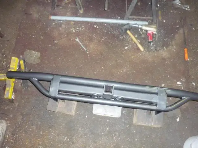

It was a little more work than I expected by drilling 16 holes in the 3/16" mount, but after 3 nights after work on the drill press I finally got a chance to do some welding. Any advise on my welds from the looks (or should I post my skills in the crappy fab thread)? This is the first time I've laid beads short of setting tacks or making my buddy do the work. Gotta start somewhere!
Here are the sliders in their two positions, not a lot of room to move them, but there is 2.5" of adjustment between the "in" and "out" mounts. I'm thinking of using hitch pins instead of bolts.
How are you going to keep them from rattling? or is that not a concern?
