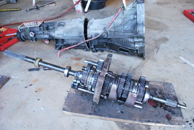

A friend gave me this manual transmission from a Nissan 240 today - I think some of its internals might be a good candidate for a rear driveshaft disconnect.
Diff Whack Daddy
And the Roll Over Posse! Under the Hood Moderator
Staff member
Moderator
February 19, 1999
3,789
5
Mount Vernon, WA
1st Gen XLT 4dr
Callsign
KG7VTT
What the beep make you look at a nissan tranny and go "oooh, rear driveshaft disconnect"?

AHah yeah thats pretty much it. And most manual transmissions work the same way so really any manual transmission would work.

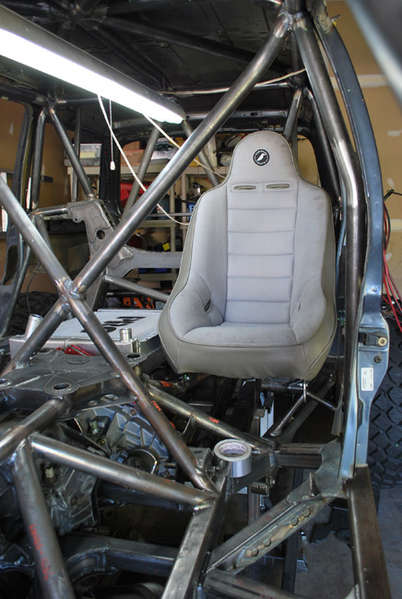

Mounted the rear seat:
