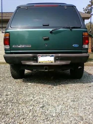

I started some of my rust removal, aka "operation eradication"
I got the grinder out and ground the rust off the rear bumper and now its coated in bed liner. You can also see my dual CB antennas.

Looks good vince, my 2nd gen bumper was too far gone and went with a 1st gen bumper.
This was pretty bad, I figured i would give it a shot, but i foresee the rust returning. I ground a lot of metal off and i still wasn't able to get all the pitting out, mainly down near the bottom edge in the middle. The grinder didn't fit real well in there.
Did you try covering the backside too to help prevent rust from developing?
No, the rust spots i ground off were only on the face of the bumper. I didn't even take the bumper off. I just popped the plastic pads off and worked with it in place.
