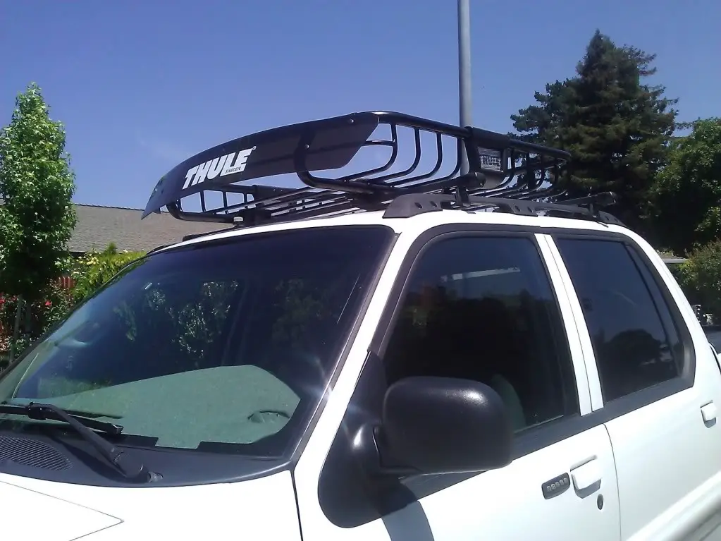

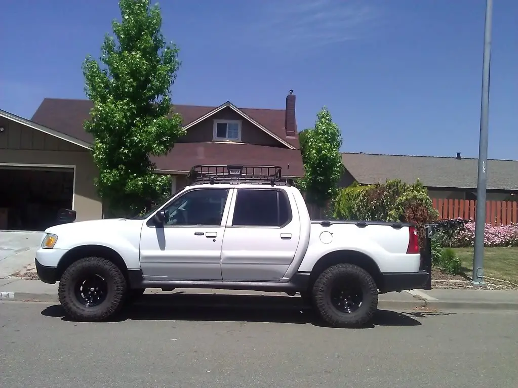

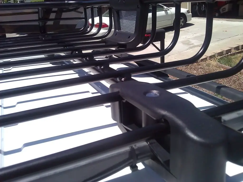

i posted this on a few threads already but thought that id add a few pics on my reg of my brand new kick ass thule MOAB roof basket.
What brand and type of tires are those?

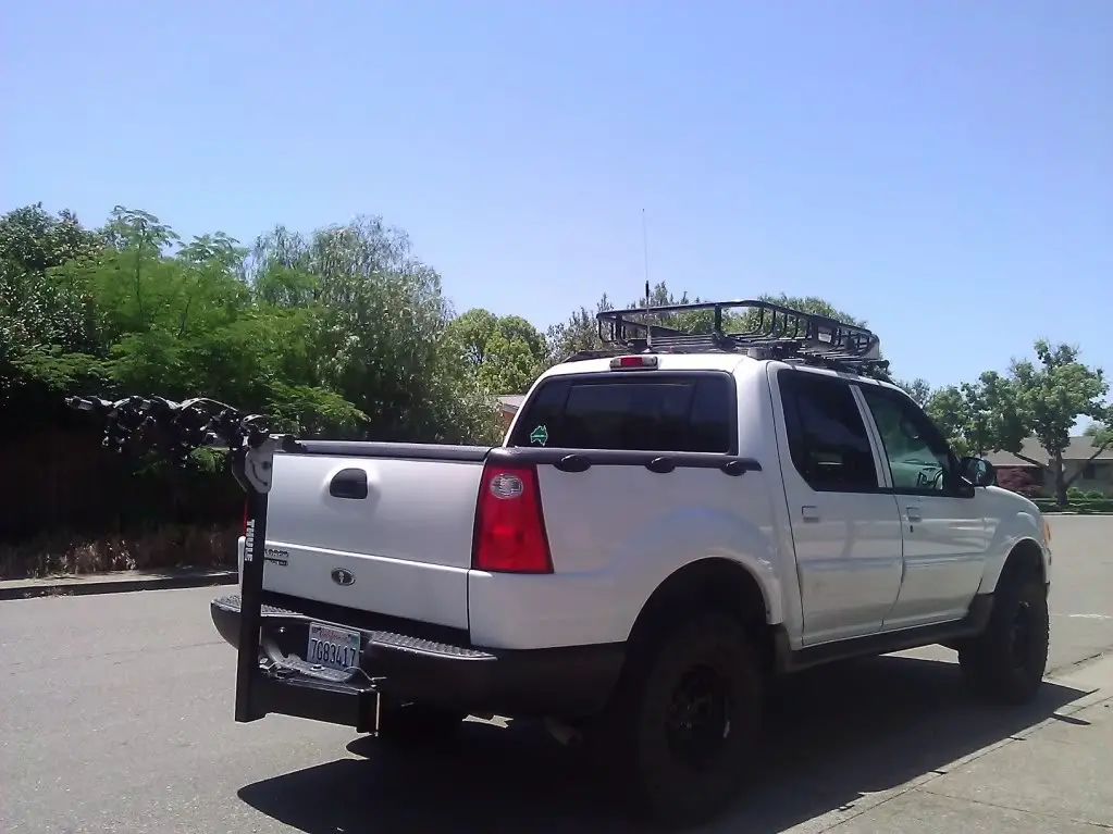

heres a shot with my thule apex 4 hitch mounted rack i got for free from my shop. score!
