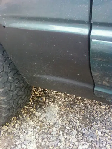

Here are some pics of the passenger side. I just need to throw the trim back on. I cant decide if the silver trim needs to be painted black as well. Its a little dirty in that one picture, sorry.

Thanks Glen. I'm very pleased with it. This side only needed the dogleg. The other side is the hard one. Dogleg, and the inner and outer rocker. I'm starting that one Friday.
It only needs put back together. I would have finished it up today but I am starting to get sick so I figured it could wait.

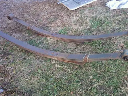

Got some leaf packs. Hopefully wont be saggy. They were removed already, and only 35 a piece. I really didn't want to climb under a truck in the mud this time of year, and pay the 50 a piece the you pull it charges. They are from a 99 with 100k, and are in pretty nice shape.
Ill be ordering the AAL soon, and making or ordering shackles. I will need to get new bolts for the shackles and hanger, as well as to hold the leaf pack together when i put the AAL in. While I'm at it ill order new bolts for the torsion bars for the TT, as the drivers side bolt has trashed up threads.

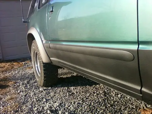

Recent shot:
The brake bleeding is a bit time consuming and repetitive but a pretty easy job as I found out today. Looking good sir!
