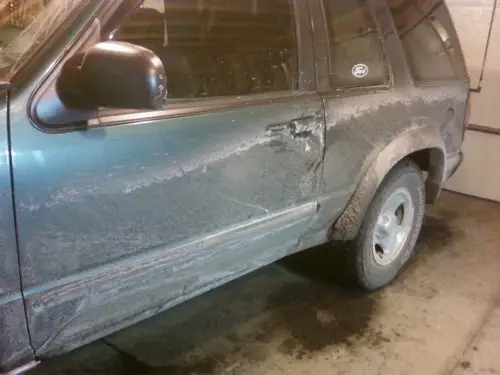

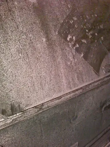

Yes, rock salt destroys. It eats everything.
This is from a week of driving in southwestern PA, and I cleaned it twice last week:
