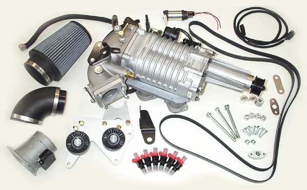

It is possible for someone to custom fabricate a supercharger onto a V6 SOHC. If you have fabricating skills, welding skills and an endless supply of raw materials. There is a matter of tuning once you do get it to run. I can tell you, we spent six months trying make a design that comfortably mounts the Eaton M90 under the hood of an Explorer. There is a reason why we went for the M62 blower. For one it fits. It has an internal bypass and easily puts out 7lbs of boost.
I respect a guy who is willing to take on such a project. But there is a reason why a junkyard blower costs $200 and a refined supercharger kit cost $3995. Some guys do not know what they are getting into. You can look at what Doug has done as an inspiration. But also consider that Doug is one extremely capable indivisual and apparantly a very good welder. Your results will vary!
Our kit has a cast inlet adaptor and discharge manifold, special EGR tube and air filter box. It also comes with 30 psi injectors, 80mm custom calibrated mass air sensor and a custom Apten Chip. This kit has been in the works for threes years. The idea of a custom kit up and running in a few weeks would be quite an accomplishment.
