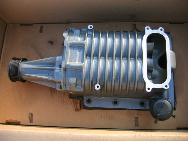

maaaaaaaybe...........
as i said, i doubt it, but it is a possibility. this thing is not suppose to be a race truck and i have to keep thinking that way. i have my screen name for a reason lol.

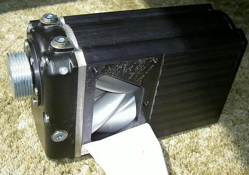

kenny brown?
- January 22, 2007
- 10,174
- 2,207
- selkirk, manitoba
- 98 supercharged 347 sport
duh, kenny bell *face palm*
im kinda leery about them. i know a few years back SVO had a motor go south in his boss's (at the time) shelby. it took the motor out after something like 200 miles. kenny bell knew about the problem but did nothing for him or the other people that had them. they gave him a major hard time with it. i cant remember the outcome, but after hearing about it, i will never buy any product they have for sale.

The KB blowers are not actual KB products, they were Autorotor(of Europe) components sold by KB. The products are excellent, KB is just a hit or miss customer service company. I don't have any personal experience with KB, and I've read a few of those stories too, one from a friend on here. Whipple is evidently the current high end blower to get since 2005.
