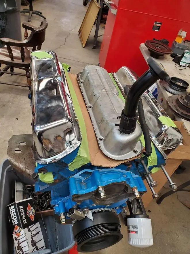

Valve covers will clear the headers and EGR. BARELY.
Somewhat relieved to know my EGR tube wasn't the only one that fit this terribly. eBay headers? I wound up having to put a 1" spacer between the intake and the throttle body elbow so it would line up.
Anywho... thanks for documenting all of this! I'm also planning an engine build and this has saved me a bunch of time.
They're the OBX headers, yes. At the end of the day they'll probably work fine, but I'm glad the engine is on a stand to sort out the fitment issues. It's mostly frustrating because they're welded together really well - it's a gorgeous set. But clearly whatever they're using to get everything positioned right before welding just isn't set up right. Lots of small issues. I absolutely could not have installed them in the truck. Wouldn't have been able to tighten some of the bolts because the pipes wrap over them too soon, and the flange issue on the driver's side required a belt sander to sort.
