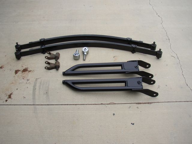

..Stupidlift RA's
...Soon to be history and will be replaced with this set built by BTF...More info can be found here on buying some new RA's for those interested...
http://www.explorerforum.com/forums/showthread.php?p=2553064#post2553064
...I have been gingerly driving around on the last set of welded up stupidlift's I will own..There is nothing worse than wanting to go mob on something but yet, you have to worry about how hard your going to hit a railroad track and pray you don't break another RA..:eek:
