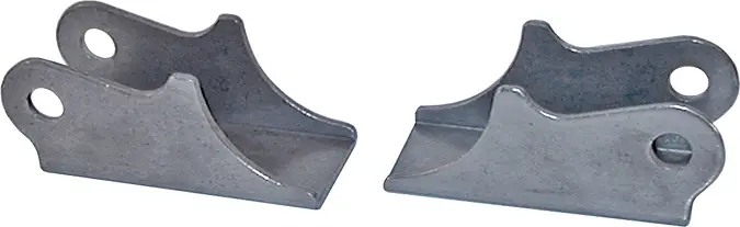

..Today I had some time to do some cutting and finally got my Currie 8.8 shock tabs welded up in the rear and I even got to rattle can spray some black paint...:biggthump
..This also allowed me to finally install the shocks I got from Sirhk100 over a year ago (Thanks again)...They were a little longer than what I had on there so I needed to add the new shock tabs..:hammer:

Show us the shock tabs. :D
..The old ones or the new ones?
..I took two pictures yesterday with my phone of both tab set-ups together and they came out blurry..:banghead:
Here is a link for the new ones..I'm actually on my 3rd or fourth set due to swapping axles and set-ups but my Ranger use the same ones..;)
http://www.currieenterprises.com/cestore/productsRE.aspx?id=1824
...Sway bar?..What is his thing you speak of kind Sir?
..Yes, these are welded to the 8.8 tubes..This way you can mount them where you want to along the tube...This is also useful if you want one shock forward and one shock to the rear like the Ranger stock set up..

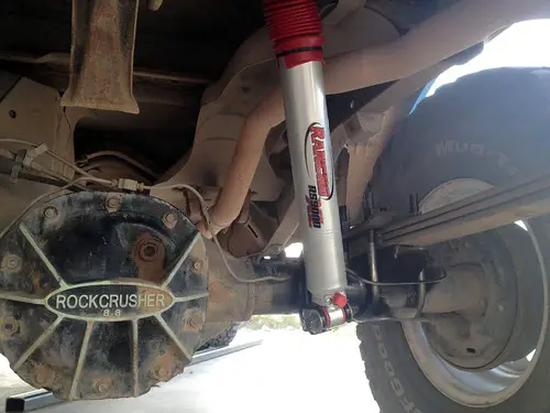

I looked at the style you used but I couldn't figure out where to put it as there isn't much room on the tube with the factory sway bar mounts still on there. I guess I could have ground them off.
Pic 3 - New shocks on SOA by maniak_az, on Flickr
I could see that style working for one in front and one in rear though..

..I actually mount mine right under that position..
..I cut 1-1/2" from the bottom up, do a little grinding and cleanup and then have them welded just below but butted up to where the perch was cut which puts it just a little lower than what you have shown..(it always amazes me the depth of the pits in the tube from the factory..:eek: )
..I'm not really worried about having them below the axle tube although my other set-up was tucked up high and mounted at the top of the leaf springs..
...I've found shock bodies have become longer over the past few years while my springs are flat and can invert, which causes the rear shocks to bottom out..
..Since I still haul some trailers and do pack the cargo area at times I wanted to get some better shock control before I try to sweet talk an old retired guy down in San Diego to help build me a new leaf pack like his..:D
