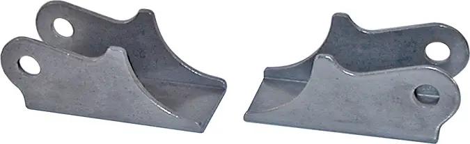

Here is a link for the new ones..I'm actually on my 3rd or fourth set due to swapping axles and set-ups but my Ranger use the same ones..;)
http://www.currieenterprises.com/cestore/productsRE.aspx?id=1824

Keep an eye on the upper shock mounts. The mounts flex quite a bit and mine cracked across the entire mount.
...What did you do as a repair?
I've had my shocks try to rip out in both directions and I'm surprised the mount hasn't tore loose yet but I haven't looked at it real close lately..:(
I cut out the cross brace and put in a piece of 3/16" wall 2x2 square tubing.

Are those top mounts single sheer now or is there something on the other side of making it double sheer?
I expected you to use square tubing and cut out the bottom piece so the shocks would go up/into the square tubing and use the walls as the mounts for double sheer.
~Mark
Single shear. Been like that for over ten years. I was thinking about making it double shear but if it ain't broke.....
