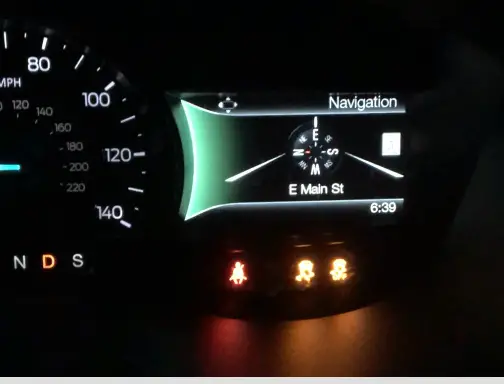

I was driving through town at low speeds and suddenly my dash starts looking like a Christmas tree...
I received the following messages repeatedly: Terrain Management System Fault, Service AdvanceTrac, Hill Start Assist Not Available. I also had the two amber lights on in the picture.
At a stoplight, I put it in park, turned the car off, then started it back up. The messages returned. I went about a 1/10 of a mile down the road into a parking lot, parked and turned the car off. I then let it sit for about a minute and a half, then started it back up. No more lights, but things seemed off with the accelerator and transmission. I've read some real horror stories about these messages, though I haven't found where anyone had all 3 of them together.
A couple more things:
  • It's a bit wet out right now.
  • When I attempt to accelerate, it seems to have a delay. The transmission seems off.
  • I know I need new rotors.
  • About a year ago I had some damage done to the drivers front side. A Ford dealership handled all repairs. It's been fine until today.
Obviously, I'll get it into the dealer as soon as possible, but if anyone can provide any suggestions, I'd appreciate it.

I went to my mechanic buddy yesterday for a control arm and he scanned for faults. ABS sensor driver’s front! You’re right. I had it changed at the same time.
