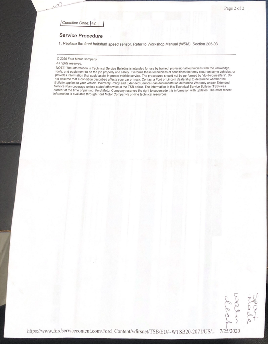

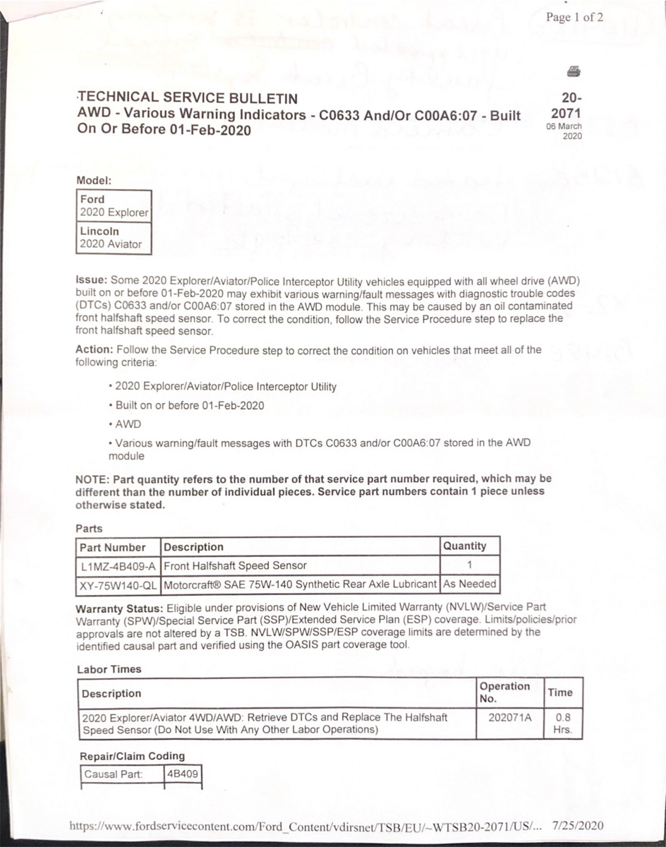

Hi all, I am new to the forum and have been experiencing the same issues with the AWD system.
Replaced the shaft speed sensor, cleaned the connections and all accordingly to the TSB protocol but still same issues.
The one which consistently comes back is “4WD Fault Service” the other usual suspects come and go.
Narrowed it down to short to ground or Internal power issues inside the module.
Will heck connections to the module inder the driver seat as well as seat.
Thinking of getting a new Control Module.
But my question is, Is it plug and play or does it need reprogrammed??
Ran self tests and got as well as DTC and this is what I got (attached).
I will also attempt to document what I find along the way, in case this can help someone.
Thanks for any help ;).

The last time someone had so many different codes and were thinking speed sensor vs. axle hub actuator vs. transfer case vs. awd module... it ended up being the AWD module.
Unfortunately, I do believe proper firmware needs to be installed on the AWD module using FDRS. The reason I say this is that sometime MY2021, Ford replaced the axle hub actuator with an "intermediate shaft" that is not controlled by the awd module and therefore, has no wired plug (like the axle hub actuator has).
That said, I did read one case where the dealer actually found that the connector to the AWD module had come loose and once reinserted, the codes never came back. Maybe check that before you see the dealer. I have not read of any end user just swapping the AWD module themselves and calling it a day. That certainly would be cost effective though.
