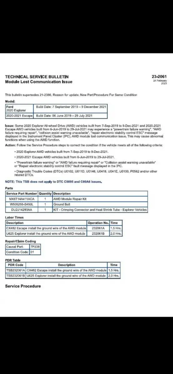

Yes, I spliced from black / white lead #46 coming from connector onto chassis reusing one of the 3 bolts holding the module to the chassis
So you totally bypassed the ground in the module and hardwired lead #46 to the chassis?
My interpretation is:
1) remove pin 46 from harness and cut.
2) Splice in secondary ground wire and connect to chassis.
3) splice pin 46 that you removed and reconnect to new ground wire/harness connection.
4)Reconnect pin 46 to module.
5) Clear dtc and drive around.
So basically 2 splices to the existing wiring harness - 1 to the chassis and 1 through harness to make connection back to awd module.
Is this correct? I’ve read the tsb 20x and am still confused

I left #46 connector in place.
I removed some of the isolant from the B/W wire on the exposed part just passed the main connector and grafted (soldered) my external solid core ground wire on the bare part of the wire, and taped.
The other end of my new ground wire is held by one of the 3 module bolts.
This was a “test” temporarily fix I did to see if it would solve the issue, and so far, it works.
Just for curiosity sake and because I wanted the “FORD permanent fix”, I went to the dealership, printed TSB in hand and tried to get actual parts, and very “interestingly” they were in total shock to find out about the TSB and didn’t carry the parts.

Ford can’t locate the wiring kit for the bad ground TSB. They’re going to replace the pin, charge me 1 hour and if the repair fails they will install and program a new awd module for free (I pay for the module). Some dealerships go above and beyond still! I’m going to pay the hour instead of doing the splice myself. I’m happy.
