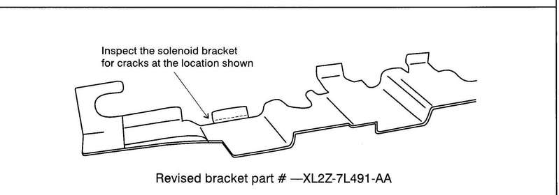

can anyone post a photo or part number of the updated solenoid bracket ?
I may already have one in some later model scorched trannies.
thanks.....jjf
This picture was in Glacier991's photo gallery:
This picture was in Jimbo74's photo gallery:
