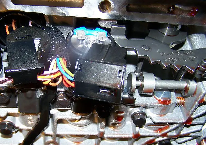

I installed my EPC last night. All went well, but I failed to take my own advice. I have always drained the fluid, and then let it drip overnight before taking the pan off and doing the work. I got impatient and only waited a few hours. The constant dripping ATF is not fun to work in. I also knocked over a pan with a few litres of ATF and that made a mess. Working in a cold garage did not help things either.
Everything went well until I tried to install the reverse servo with my new D-rings on. For some reason, the cover did not go back on as I recall last time I had it out, because the servo seemed to be protruding out of its bore. I ended up bolting the cover down, and it pushed up the servo to the point where the cover fitted flush. I changed the filter, although the old filter had only been in one year. The fluid was perfect red and no filings were in the pan. I re-used the Ford pan gasket as it appeared to be in good shape, and looked like better quality than the gasket I got from Transmission parts USA.
It’s working fine, and I don’t detect any difference, but my old EPC was only a year old as well. I really hope this is my last time going in, after four times the fun has worn off…
