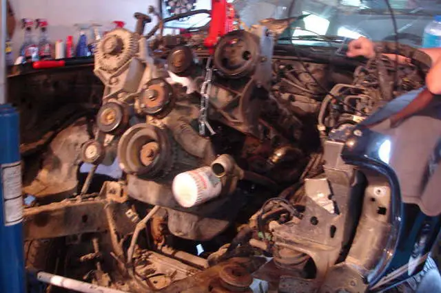

The motor is coming out of the Mountaineer and getting prepped for build up and upload into the Explorer. I started Tuesday night by cleaning the garage bay, Last night I manuvered it into the bay, removed the drive shafts and drained the transfer case. Tonight I pulled off most of the front, drained the tranny, oil, radiator and AC. Removed the radiator, and associated.
Here's the pics.

Did most of that work thursday night (3 hours) The grill and stuff was already off and I had my buddy helping me.
I still haven't decided on a camshaft. I've still got some time. Jegs is right here in town and I can get about anything in a day picked up at the store.

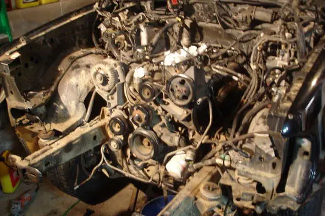

More progress tonight:
Everything is unbolted, I can't get the header bolts off at the collector, they are rusted too bad so I'm going to have to lift the motor off of them and cut them. They are off of the block though. I still need to disconnect the fuel lines and the tranny linkages tomorrow morning, then the motor is coming out tomorrow afternoon.

So that was 5 more hours tonight. Probably 3-5 more hours tomorrow and it will be on a stand and ready to start being cleaned and built.
As I am looking around, I'm seeing other things I need to replace too. The cost keeps going up. My idler pullies are a little wobbeley, I'm going to have to replace them as well as the tensioner pulley.

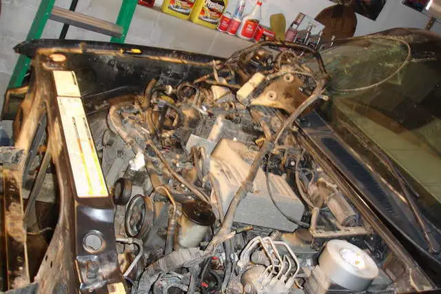

Finally!
look ma, no motor!
Very good pictures, and I like the blue cherry picker. Have fun with the cleaning, that will be the worst part. Truly have fun with the assembly, that's the most satisfying. Regards,

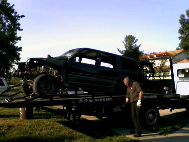

Today, I stood sad in my driveway as my long and rocky 20 month Mountaineer road come to a sad ending.<playing taps>
I hate scrapping cars, there is always a lot that you wish that you could save and store away. My 93 and 99 Explorer scraps looked like somebody got a hold of it with a large pair of tin snips. We had cut sections out of the frame, and the whole body was cut down in pieces to fit on a trailer. The scrap yard emptied it in a few minutes with a magnet. Regards,

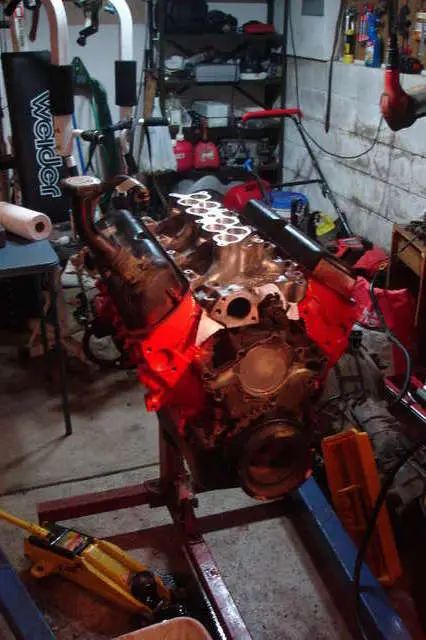

I got most of the block cleaned/stripped and painted.
My own quasai port polish job on the lower intake done with a dremel tool and a drum sander bit...
Next step, the actual rebuild.:cool:
