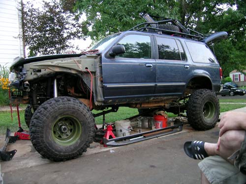

just a quick update... Havent gotten far at all on this project lately
I did happen to but some 8" skyjacker coils springs. But now im trying to think of a way to help steer these huge coils.
