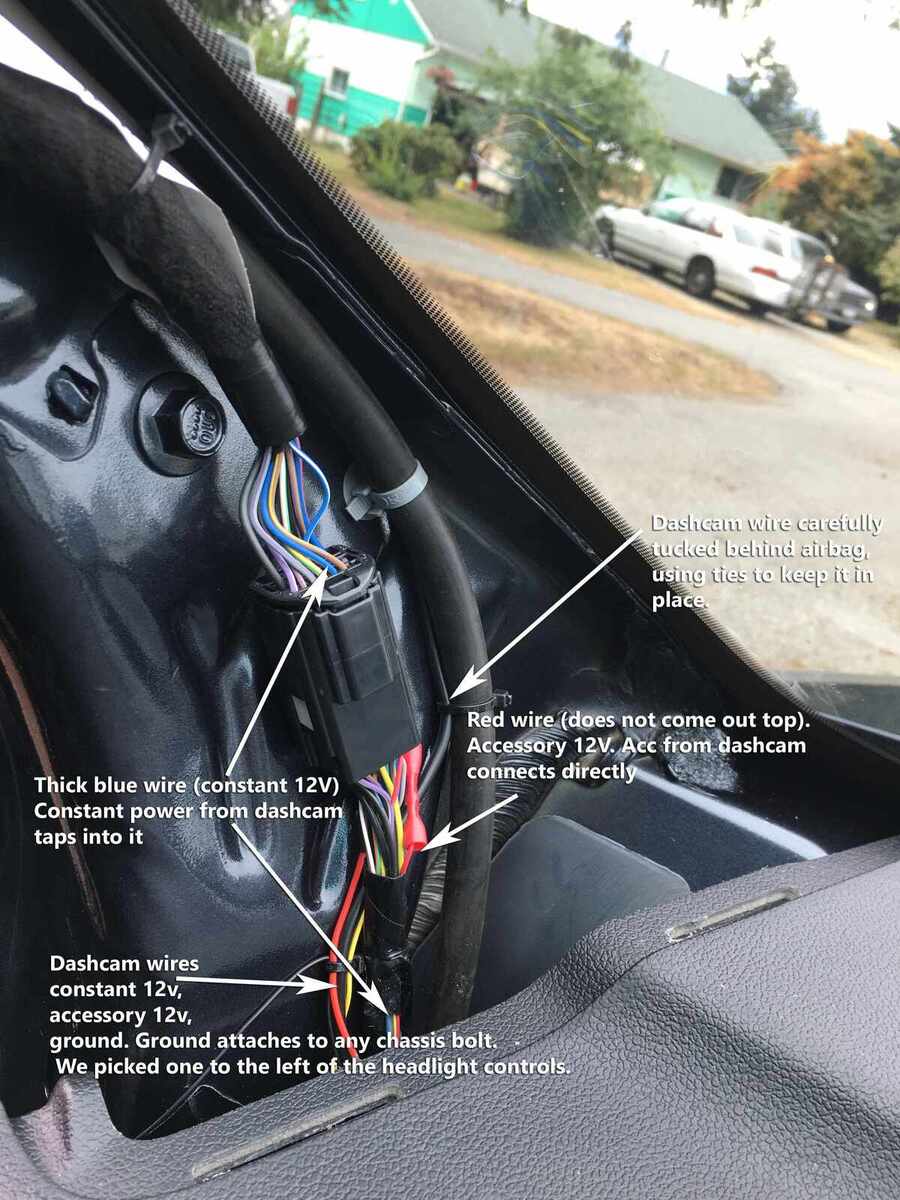

My brother is an auto mechanic, so he hardwired it for me. He wired it into the driver's side A-pillar. There is a large molex plug, and he tapped into that. Pulling the panels off to access the A-pillar required no tools. After watching him work, it was an excellent install. Except the wire-tap failed. I had to take it apart and wire it more conventionally -- strip the wire, and tap in directly and duct tape it. Happy enough for me. The reason the wire tap failed was because the dash cam wires are just so thin.
Airbags are a concern/risk, and there are cases of airbags deploying while wiring stuff up, so YMMV. I unplugged the molex before playing with the wires, and only connected it after I was done. Did that a few times without anything going awry. Also we used zip ties to wire it up behind the air bag. The molex also clips into the chassis, and you can pull it out to make it easy to work with.
I prepared this picture:
All the dashcam connections were made below the plug. And of course, not all cars are the same, but my loaded 2017 Explorer Sport had a red wire on the bottom that went into the plug and didn't come out the top -- so it's a live accessory wire that doesn't actually connect to anything. Who knows maybe it serves a purpose for a Platinum trim, although apparently this is a pretty common technique for car makers. So we were able to literally just cut the wire and hook the accessory wire directly to it. Platinum has a couple extra features like rain sensing wipers, lane assist, that would go up that way.
The constant power was indeed being used and had a thick blue with red wire underneath and above the plug.

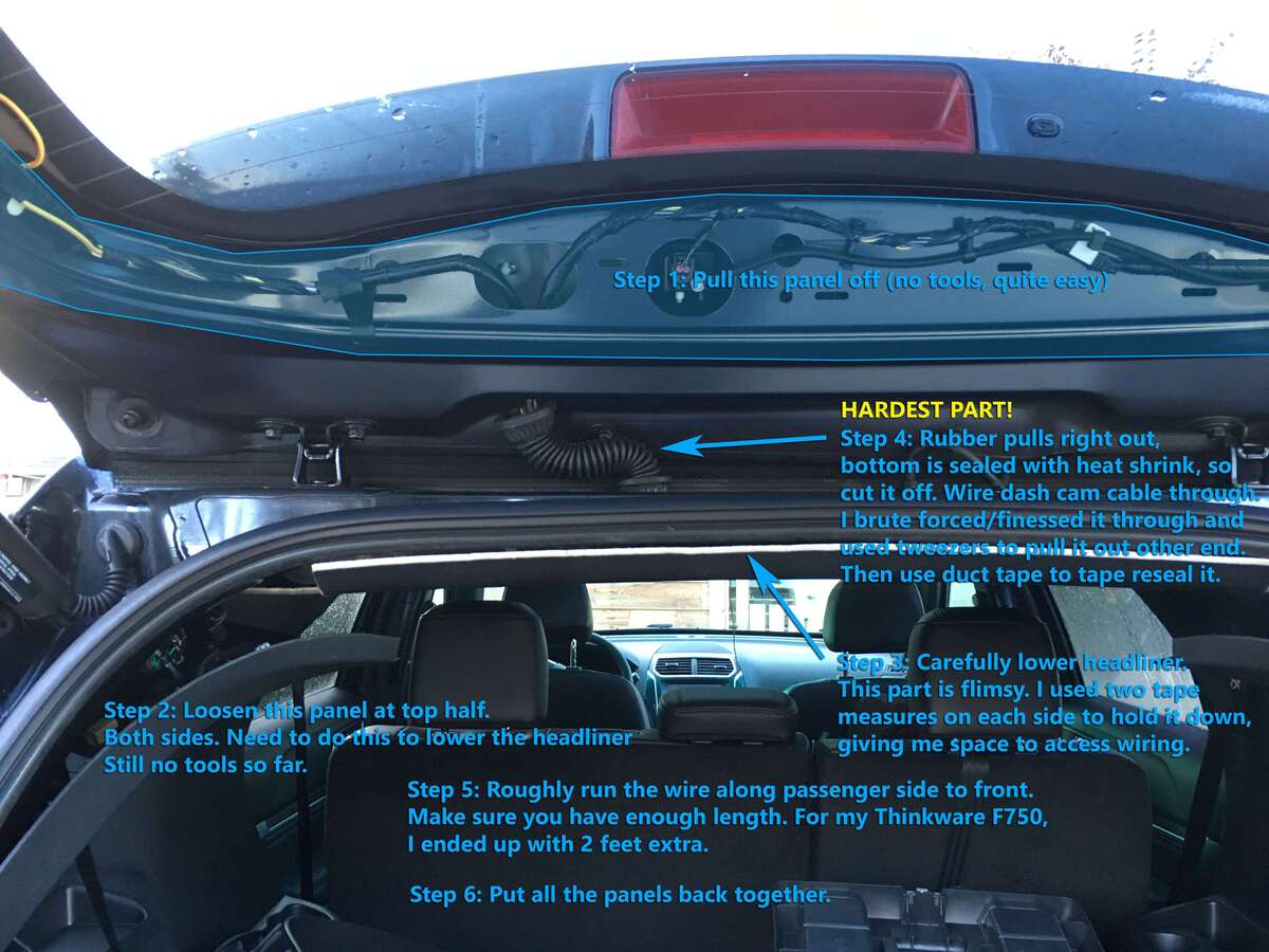

Next post, I'll detail how I got the rear dash wired up.
