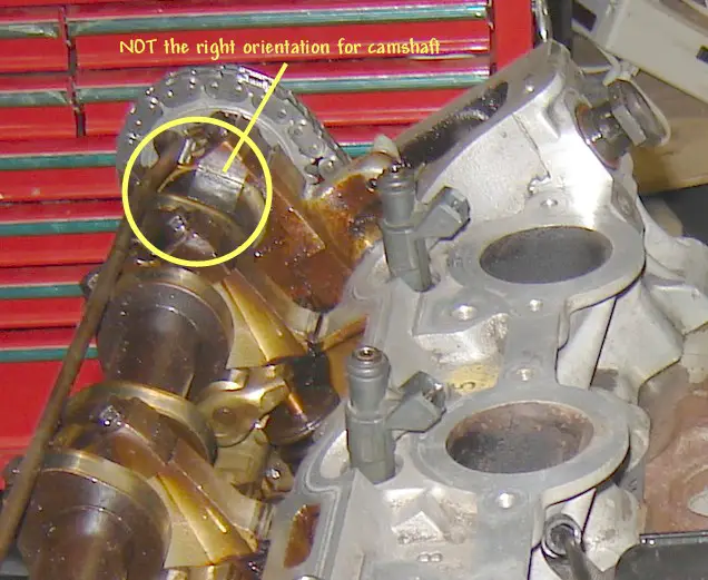

I think it is also worth mentioning that even though you use the tools, only one head can be done at a time. BUT, both the primary chain and front cassette have to be off/out at the same time as the left cassette chain is behind the primary chain. The biggest thing to make certain you do is to keep the cam sensor nub in the proper place in relation to the head. This can change even if you use the OTC6488 tool kit to hold the rear cam in place. The tension from the valve springs will cause the cam to rotate somewhat. I was victim of this during my rebuild. Got it back together, tunred it over, sounded ok but would not catch and run. We took the valve covers off and when compared to before pictures and diagrams, we realized that the flat spot was on the bottom of the cam, 180 degrees off. OOPS! It pays to take pictures and follow directions! The flat spot in the picture below is the opposite side of the cam that needs to be up at installation/tightening of the cassette to cam bolt. The opposite side has a flat spot with a nub that sticks up to "trip" the sensor. I cannot locate a photo of that, but I have not looked at everything I have yet. I will scan a diagram from the instructions tomorrow and post it for those who need it.

Agreed, I watched my two cams and valvetrain carefully when I loosened the jackshaft bolt. Only the left one moved then, I did the left first, and when I got to the right cam it had turned slightly, no harm.
I believe that if the engine is at TDC when the work begins, then the cams won't move out of position any amount that will hurt any valves. The crank isn't turned during the process, just TDC verified. So doing each head(cam) is a matter of installing the tools, which lock the cam into it's timed position. Each cam gear bolt is tightened when the tools are on, which locks that cam in time with the crank.
So after the front cam chain, and rear cam chain are done(it's cam gear bolt), then the engine is timed. That's how I would verbally describe the general timing process.
