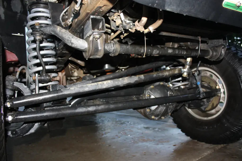

Looking to get new front coil springs. I don't like how tippy my rig is in certain situations. Current ones are RE1345 from Rubicon Express. They have a 184 lbf/in spring rate. They are intended for use on an XJ. I've been looking into it and an XJ weighs about 1000 lb less than an Explorer. I think I need coils with about 210 lbf/in springs.
The search is on......
Maybe some LJ springs? Not sure if grand Cherokee springs will work but they would be rated for more weight
I think I found my spring solution. Iron Rock Offroad out of Minnesota sells an 8" lift for XJs with a 245 lb/in spring rate but even with my heavier rig, my calculations show is get a 2" additional lift.
BUT if I cut 2 coils off, I should be right where I want height wise and it should bump up the spring rate right to the 290 lb/in range that I was shooting for.

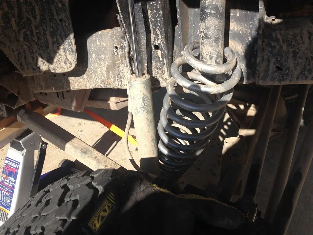

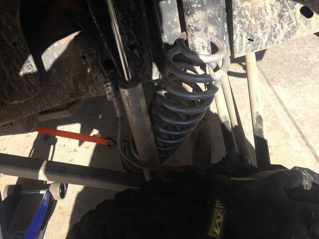

Installed my Iron Rock Offroad 7.5" lift ZJ springs today. According to my calculations, these springs as is would have given me an additional 2" of lift. I don't need any more lift thank you very much. But, doing my spring rate calculations, cutting out 2 coil would give me about the same amount of lift that I already have and give me a spring with about 280 lb/in rate. The springs I pulled out are Rubicon Express 5.5" lift XJ springs with 184 lb/in rate.
While these XJ springs flex great on the trail, I've bottomed out a couple times doing somethings that I would not expect to bottom out on. And on the road they seem way too soft and tend to wallow after hitting bumps and humps. I realize my vehicle is heavily modified and won't ever handle like stock, but I felt I could improve it.
to get the springs out, I just had to disconnect the sway bar and jack up on one side and pull it out. The first one was easy because the other soft RE spring was getting compressed on the other side. Getting the second spring out was not easy. The front tire actually comes up off the ground and still wasn't loose enough to get it out easily.
But a ratchet strap connected to the other leaf spring mount pulled it right out.
Getting the second ZJ spring in was not easy at all. I had to use more ratchet straps to act as spring compressors to get it into position. It sucked. Didn't get any pictures either.
But initial road impressions are favorable. Much more composed. I know I'll give up a little flex on the trail, but I think I'll be OK. Hopefully won't bottom out anymore.

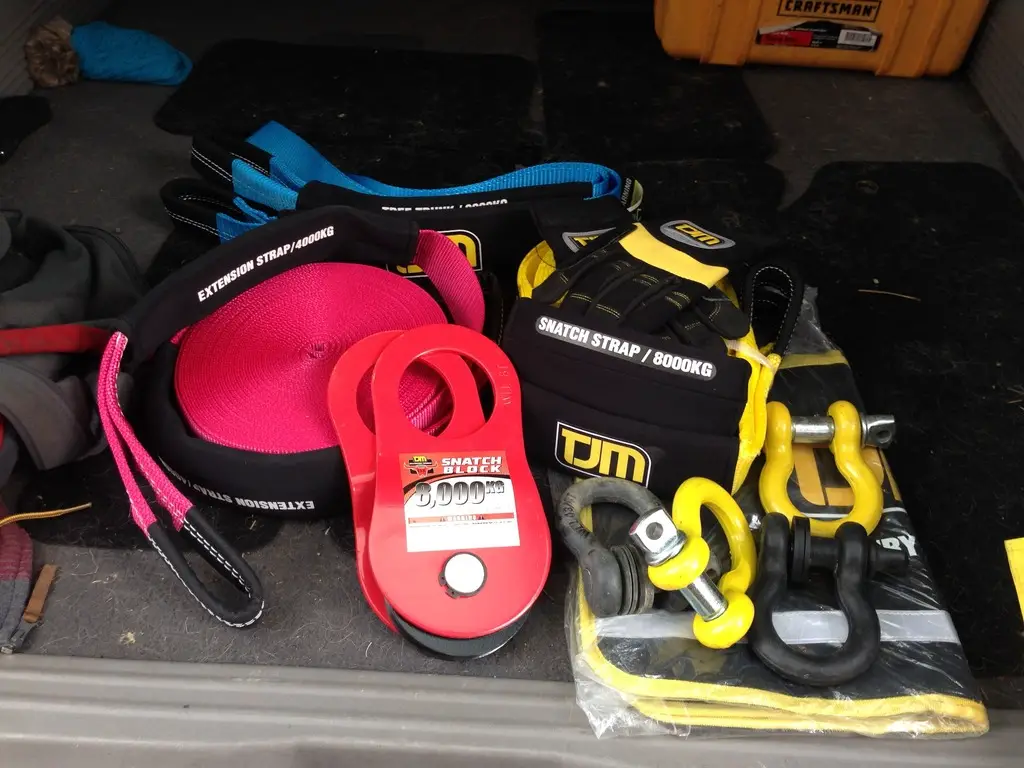

Also picked up a recovery kit from a member of another local forum:

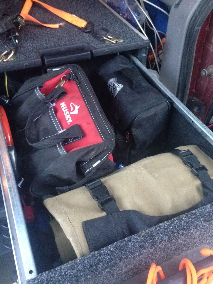

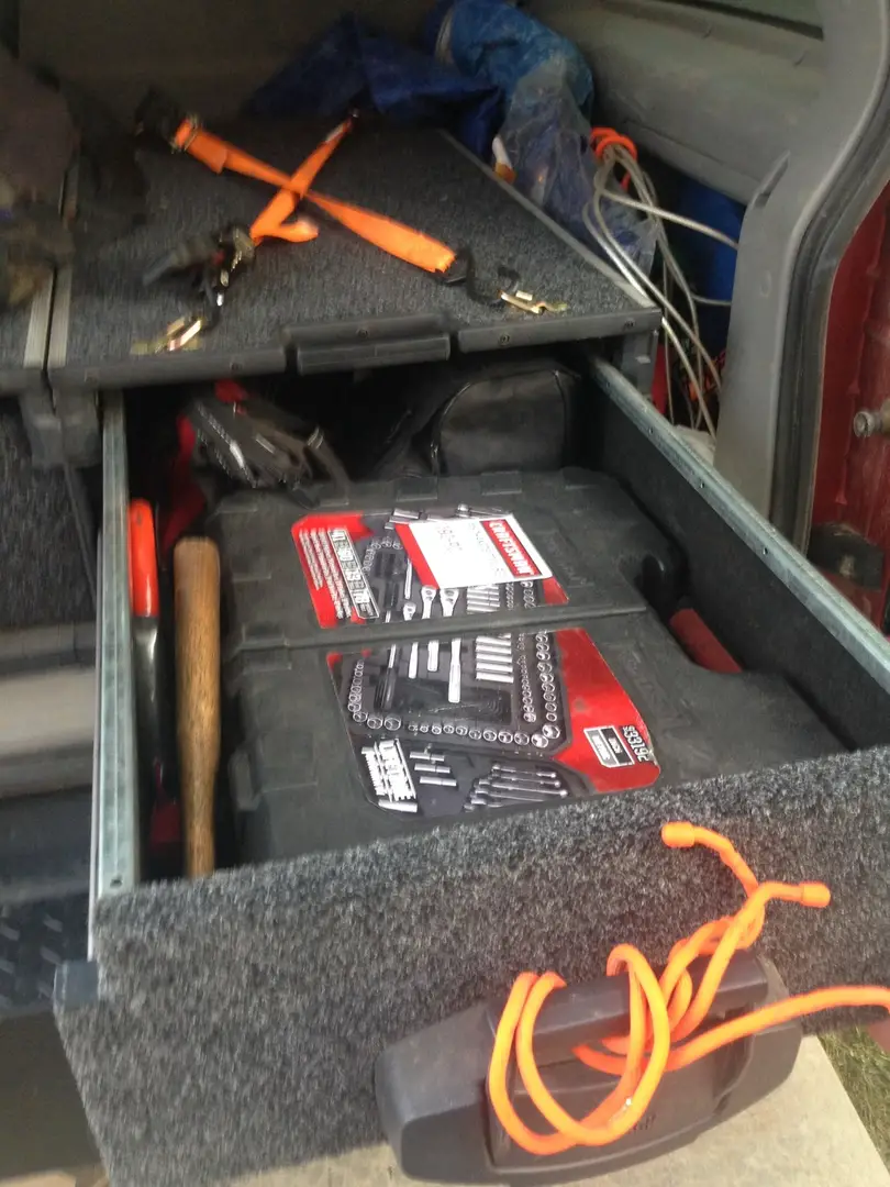

So here's my tool drawer before. Getting the plastic suitcase out was always a pain because it just barely fit with the drawer open.
Here's all the tools I packed in here. I used bailing wire to group the sockets together and carabiners to hold the wrenches together.
And then the tool drawer afterwards. Looks pretty much the same right? What you can't see is the bag of recovery gear at the front of the drawer that wasn't in there before.

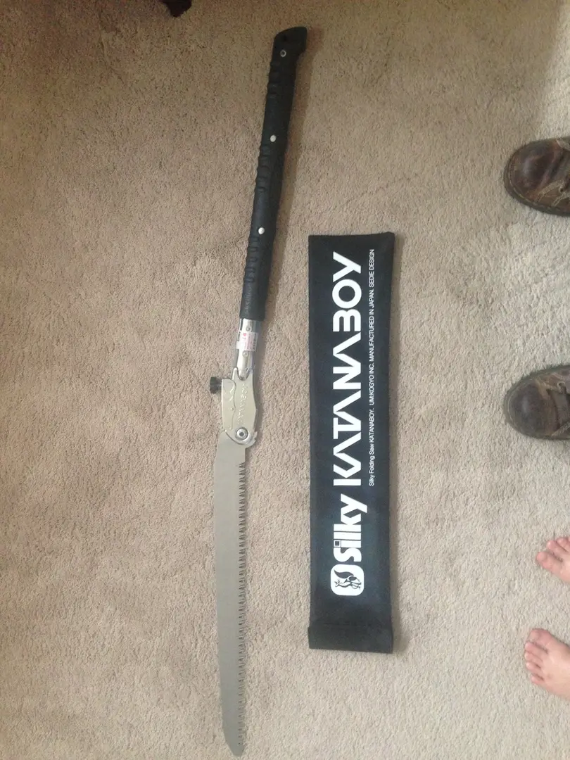

Got something to help clear fallen trees from the trail. I debated getting a chainsaw but they are bulky and problematic at changing altitudes. And oil and chains and gas (or a large inverter and extension cord......). Some guys in local overlanding group have this saw and it works great.

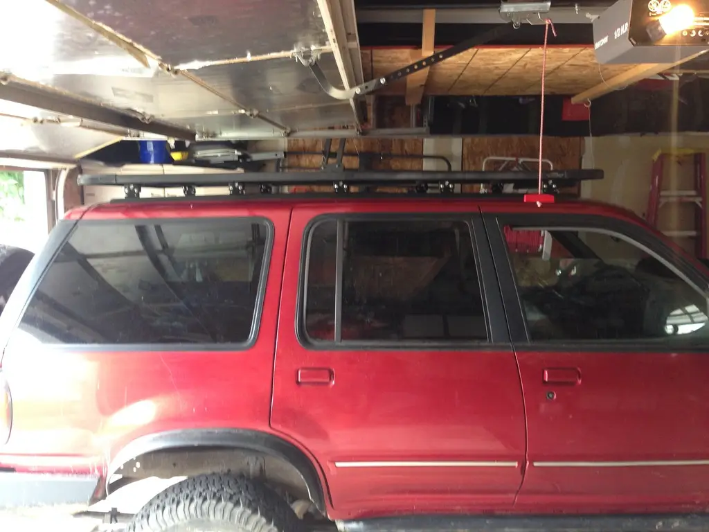

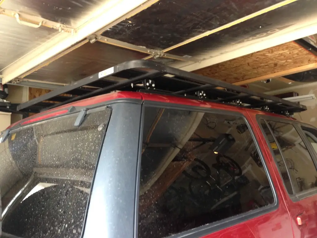

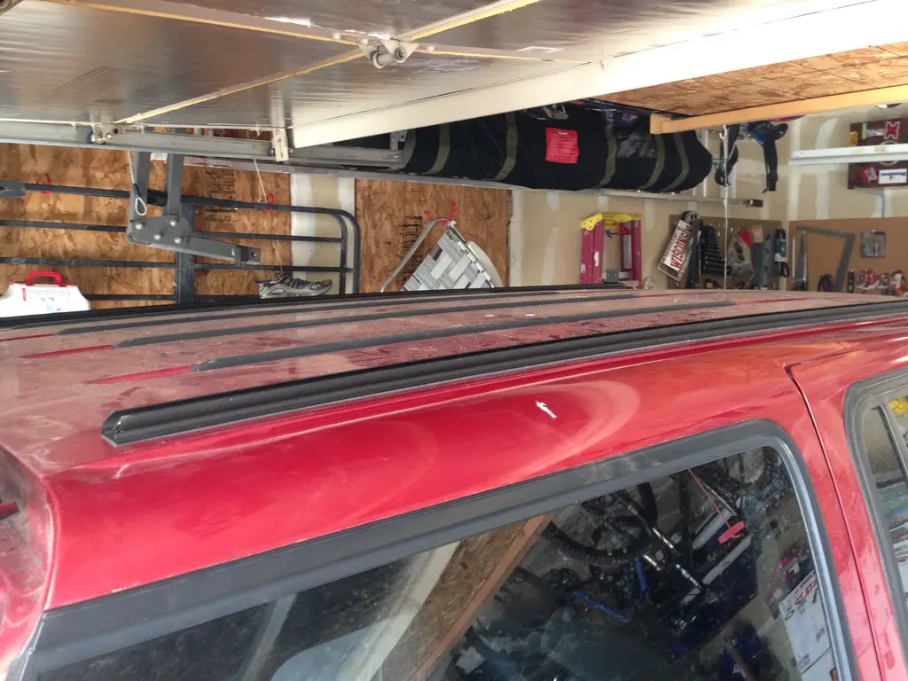

Installed my new rack today. It's an Eezi-Awn for Equipt1.com.

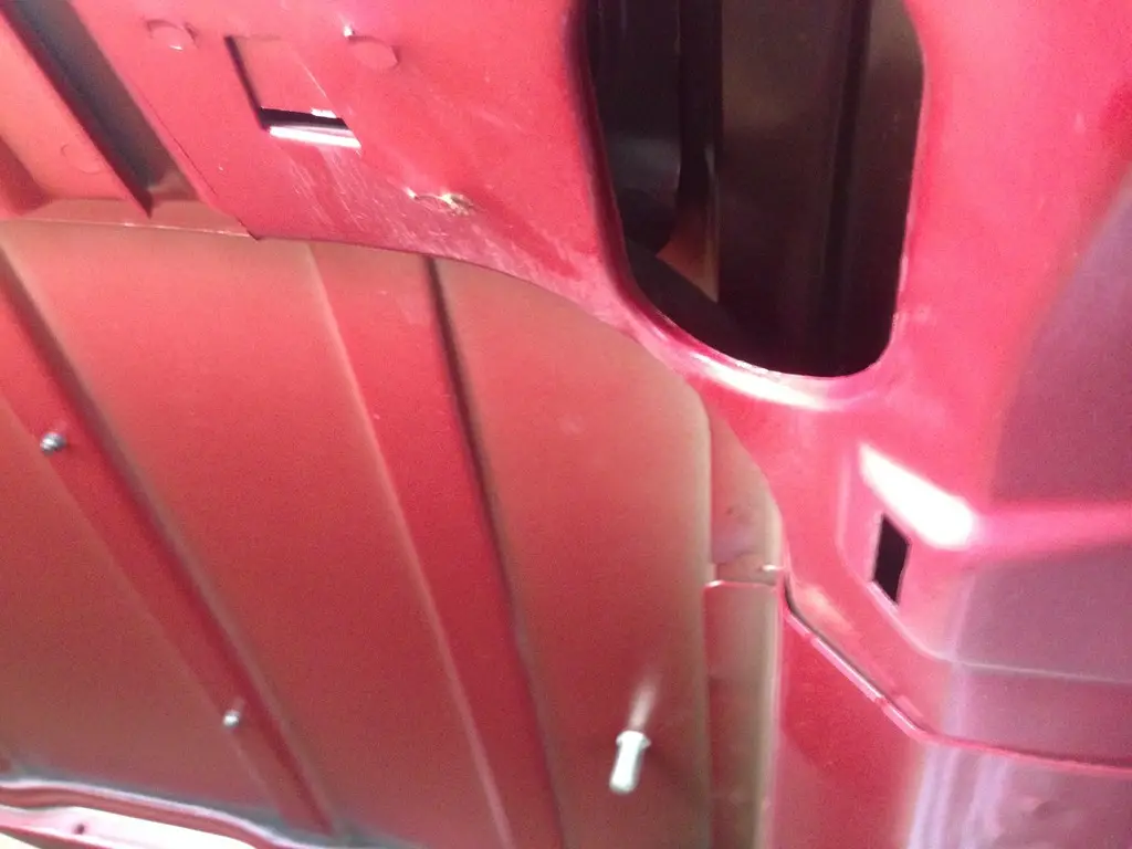

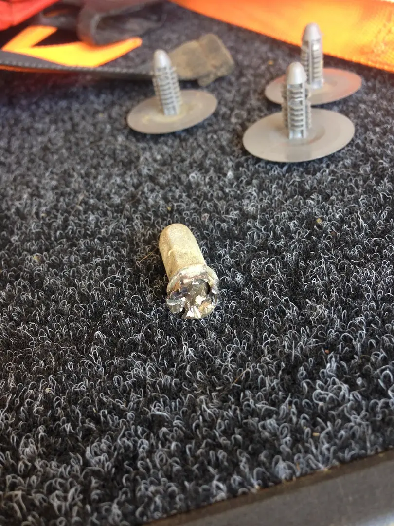

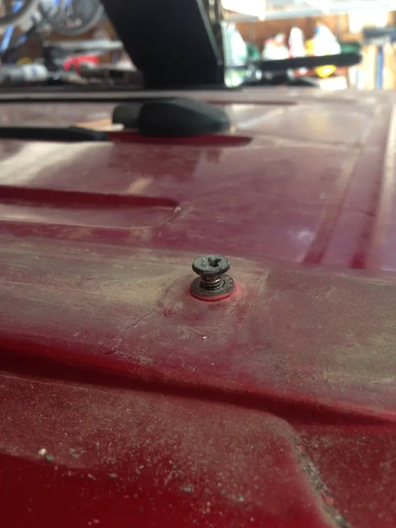

Getting the old rack off was fairly easy with a screw driver bit in my impact gun. Except the rear most fasteners on both sides just spun freely in their blind nuts- although they pulled free of the rack (which probably wasn't good).
The underside looks like this. Unfortunately, the rearmost are in this "pocket" and you can barely get fingers up in there to get a nut on:
But some Dremel action makes short work of it and I was able to push it through:

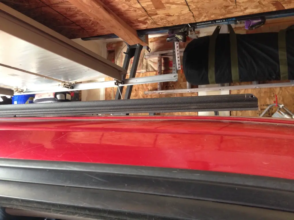

Next I laid a strip of masking tape on the roof to mark the holes. I then transferred that to the new rails and drilled them:
The new rails installed:
Because the roof is not flat- from about the B-pillar forward is pitched down, the new rail is sort of suspended in the air. Paul, the runs Equipt1 ran into this same problem on his 4Runner. If I dropped the headliner all the way I could drill a new attach point. Maybe in the future.
But with the rack feet tightened down all the way, I can push this down a little so it's not as bad as shown here.
Installed and ready to go:
How much and how long is it ? Looks good
I think I'm probably going to stick with the stock one and extend it forward all the way to the windshield
